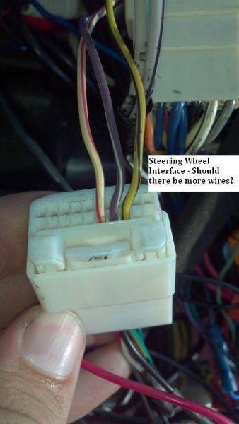

    Did you see my post above? Find the white w/red stripe wire in your factory harness and tap into it with a piece of scrap wire, then connect it to the ground wire on the remote. Looks like you bailed on it, but it sounds like you were close!

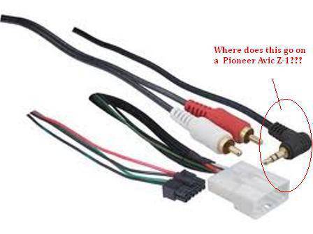

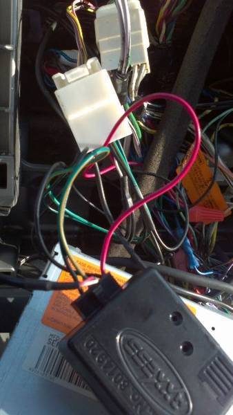

    So, I am not that savvy when it comes to this stuff. I'm trying. I got the Axxess ASWC and the Metra 70-8114 wiring harness. I hooked it up in 10 minutes, Red to power wire, black to ground wire, plugged it in, some lights blinked. Problem 1) On the Tacoma SWC, did you guys only have 3 wires in that harness? Am I missing some?
    2) Where does the 3.5mm jack plug into on a Pioneer Avic Z1?
    I feel like this is such a simple task.

    You should just be able to plug that in... Did you buy the deck used? Someone may have cut off the jack.

    It came with the taco when I bought it. I contacted metra. By say the z1 isn't compatable with the ASWC. Oh well

    Problem solved! I installed a new head unit this weekend. Hooking up the ASCW took all of 5 minutes. It programmed itself and works perfectly. 1st time in 5 vehicles I've had steering wheel controls, I like it already!
    Thanks for the help before, it made this setup easier!
