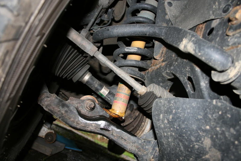

    bringing this back to life because my new truck came with a stacked lift. 04 DC 4x4
    fabtech dirt logic 2.5 coilovers which are supposedly same as sway-a-way (wondering idff anyone can confirm this) set at about 2.5 inches and a 1.5" spacer on top = 4" of lift!
    truck has manual locking hubs so no need to worry on the road.
    but the fabtech definitely completely bottoms out about 1" before the LCA contacts the bump stop.
    but, according to the fabtech website "All Dirt Logic coils posses the ability to go solid without breaking, settling or bowing."
    check it out
    http://www.fabtechmotorsports.com/dirt-logic-shocks.php
    Does that mean i can bottom out these dirt logic coilovers and use them as "expensive bumpstops" and not worry about them breaking?

    Definitely not. Sure they might handle some abuse, but over time I'm sure they will break or at least wear out parts prematurely.

    Noooo!!!!! The only thing designed to stop suspension travel is the bump stop.

    theyre refering to the coils in that statement. they can be fully compressed without damage (you wont fully compress them on the shock)
