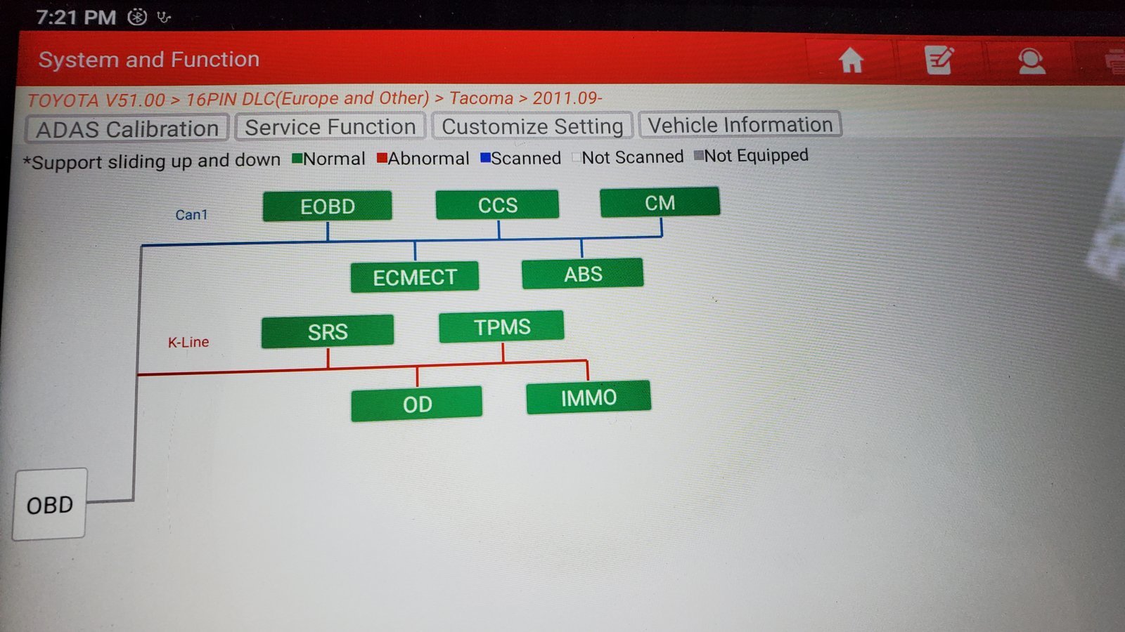

    A cam or crank sensor problem wouldn't cause a no com.
    It's starting to look like a bad PCM but I'm still curious why you can't talk to anything else if your scanner is capable of it.
    I'm assuming you checked for spark and injector pulse and are missing one or both?
    Even if the CAN bus was offline you should still be able to talk to the SRS, Occupant Classification ECU, TPMS, and Immobilzer modules as those are on K-line.
    If you have access to a scope there's other checks we can do.

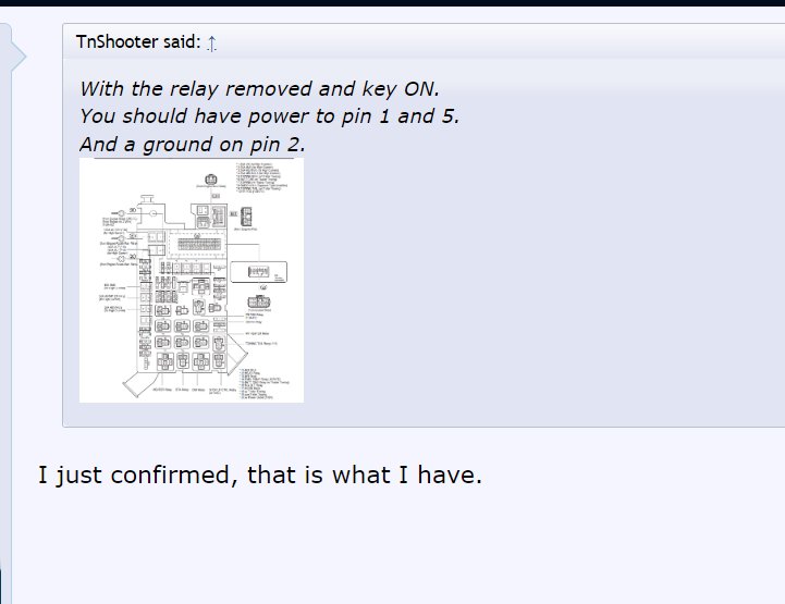

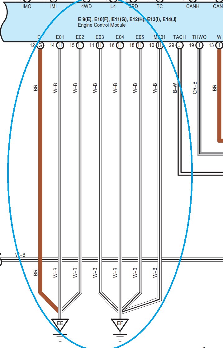

    I might have missed it, but you did confirm the grounds were good at the ECM?
  15. Mar 22, 2024 at 5:44 PM
    #55
    TnShooter
    TnShooter The TacomaWorld Stray
    Sep 2, 2010
    #42625
    21,146
    Deogee
    07' TRD Off-Road, Auto
    STOCK
    These grounds

    Ill check with my brother in law, he ran those grounds. I just hooked up the scanner again and ran the ABS and SRS and the reader says:
    ABS-VSC-TRC (CAN) = Pass no fault
    SRS Airbag(SIL2) = Pass no fault
  17. Mar 24, 2024 at 4:09 PM
    #57
    TnShooter
    Sep 2, 2010
    #42625
    21,146
    Deogee
    STOCK
    Well that is good. That means the can bus line is online and good.
    It's looking like an ECM issue. Still not ready to condemn it though.
    Make sure those grounds are good.
