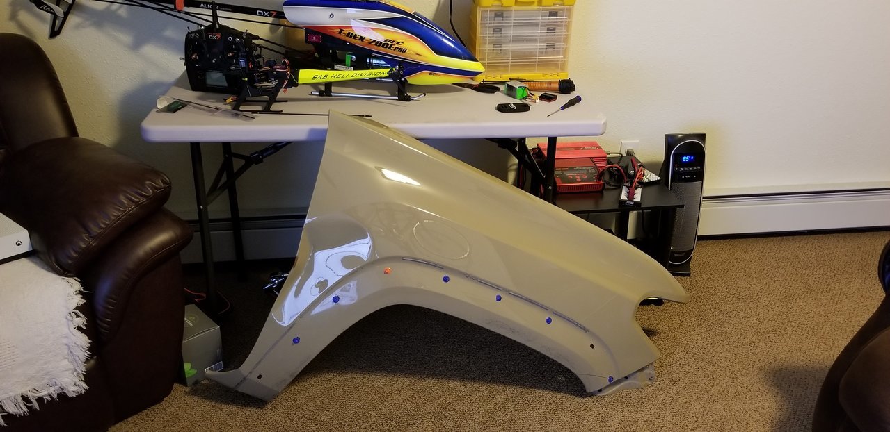

    Reviving this thread again..ahahaha. Took my OEM fender flares to install some buschwackers, but there is a orange pin that simply dont come off. Any ideas?
