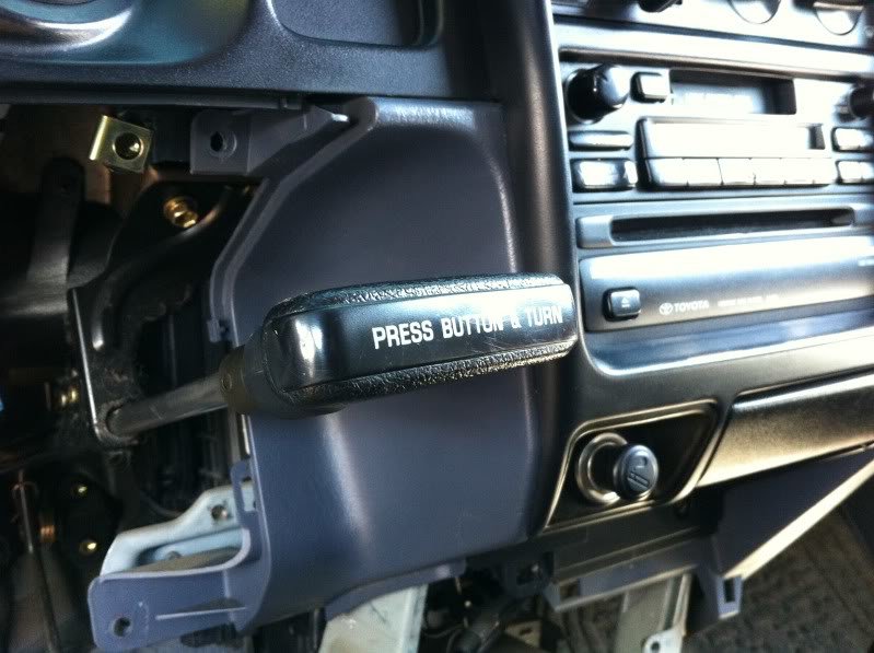

    Can't for the life of me get this piece out. It's the little trim piece directly to the passenger side of the e-brake handle.
    As you can see there was a screw at the top and a bolt that went through both the trim piece under the steering column and this one. If I put my hand behind that piece (and the black trim piece that surrounds the stereo et al) I don't feel anything. Yet it is really in there.
    I don't want to force it too much because that black trim is a $95 piece of plastic and I'd imagine this little stuck bastid is expensive too.
    Has anyone removed that and remember how they did?

    Shoot sorry man! Thought it was step 8. If I were you, I'd remove the radio surround to poke around to see if there's any extra screws or hidden clips.
    What are you trying to access?

    Lose the stereo plate and you'll be able to remove it....

    Trying to remove it to paint it.
    Crap, I was hoping that wasn't the case. For some reason I'm not psyched to remove that $95 piece of plastic.

    It easy... About 4-8 screws and pop of ya don't have to pull it all the way off just lose it on the driver side a bit...

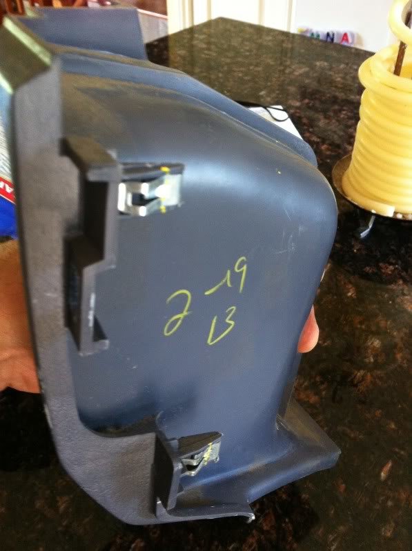

    Just removed the climate control face plate. Popped the driver's side screw out, removed the screw under the ashtray and was able to pull the driver's side of the stereo face plate out far enough to remove that trim piece (which has two retainer clips shown below)
    Thanks guys!
