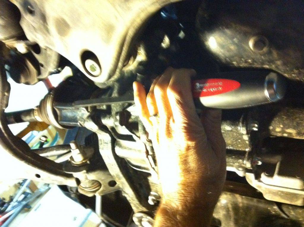

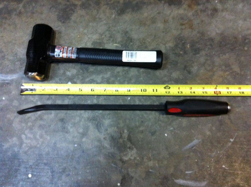

    Stopped at sears on the way home and picked up Wicked's prybars and a 4lb short handle engineer's hammer. (I'd been using a 40 oz long handle as my BFH)
    Selected the middle length prybar [​IMG]
    Place it alongside the diff and up against the grooves on the axle
    Fewer than 10 whacks, and this is the result:
    Yes! Yes! Yes!
