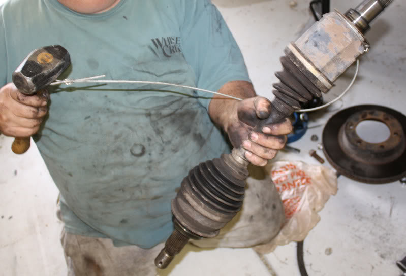

    Here is a tip about removing the cv axle, without having to pry the c clip from inside the clam shell.
    A piece of cable from home depot, with eyelets on both sides. make a noose around the inner cv axle collar and put a small sledge on the outer eyelet and give it a pull/tap out, to release the c clip
    It takes the getting under the truck and prying the axle out of the equation :bigthumb::bigthumb:
    I actually made one for my trail tools repair bag .
    If you don't believe it works, check out this thread on the FJ Cruisers forum. The results are positive
    http://www.fjcruiserforums.com/foru...nge-cv-axle-when-using-jacks-jack-stands.html

    I did this a while ago. In case anybody else is using this for reference, I did what another forum user recommended, which is attach 1 claw on a slide hammer to the notch on the CV shaft near the diff with a large hose clamp. Didn't take much force at all because you get a good solid purchase on the shaft and a nice parallel angle. Hope this helps someone because it wasn't a fun job.
