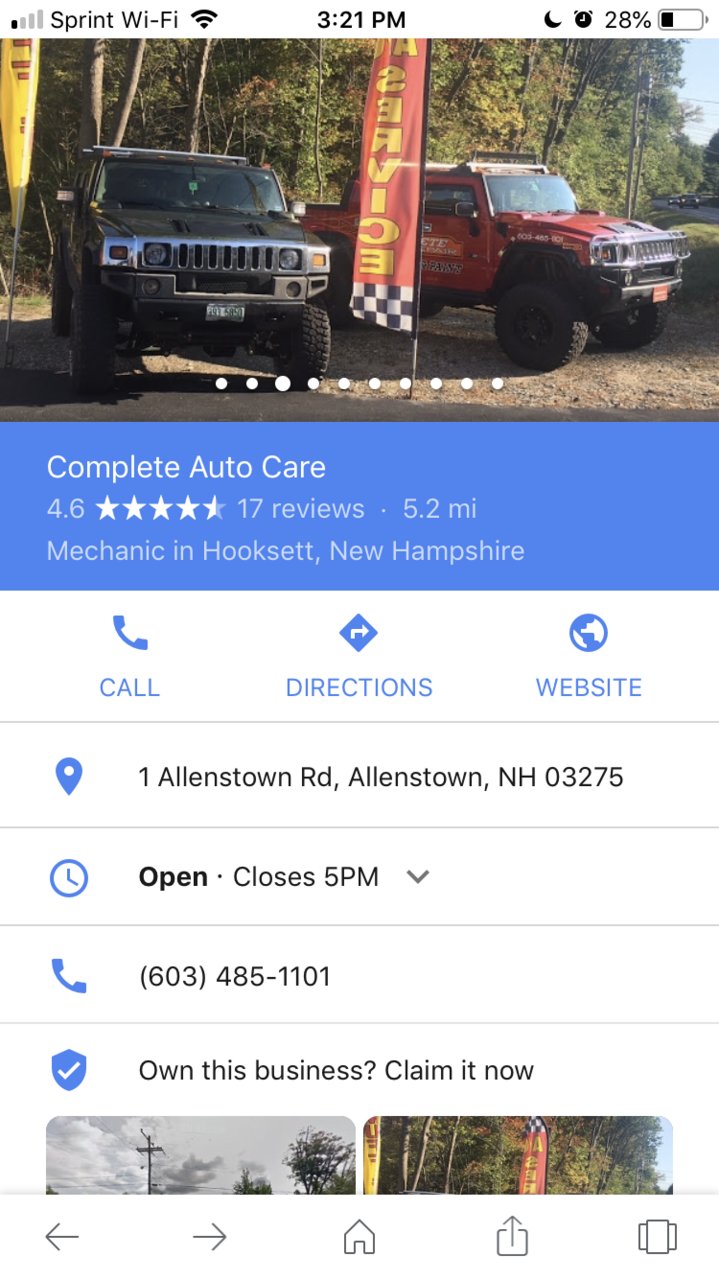

    If you get in touch w/ these guys they will set you straight. All they do are truck mods and they do fantastic work. They have a website but my dumb ass can’t figure out how to give you a link. 425250C0-F17A-40B2-BE3B-653BB2B68412.jpg

    Yea too bad their in new Hampshire unless they modify parts and ship them I'm in PA. Still looking for what to do if anyone has any suggestions ?
