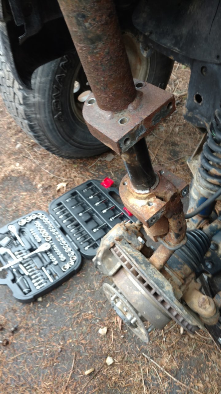

    So those are the bolts you take out

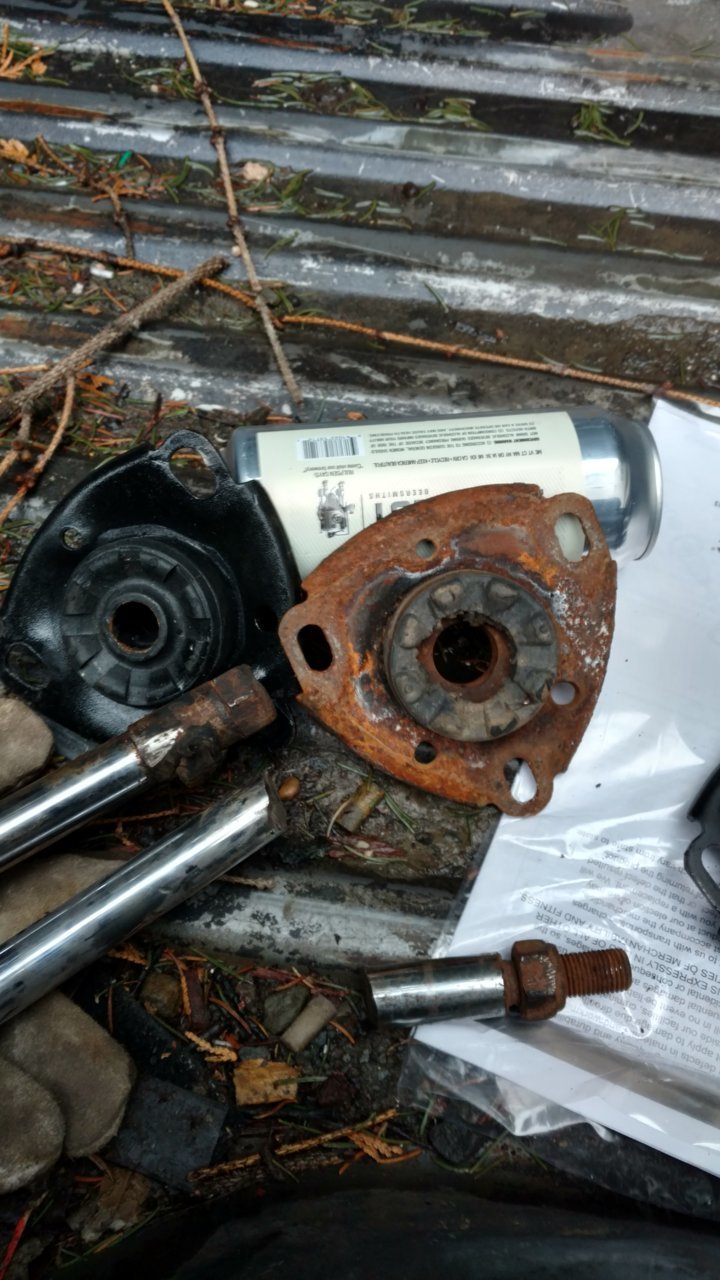

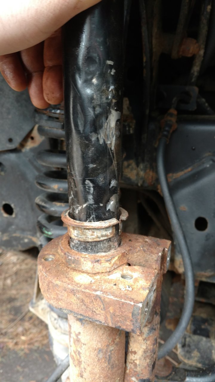

    IMG_20190302_135613792.jpg then you got to get that washer off than pull that old pos right out of there .

    IMG_20190302_161544314_HDR.jpg the old mounts are completely Blown Out . Posted the part # earlier of the mount . Waiting on struts in the mail. Posting this so someone doesn't have to do as much research as I Did . Will keep you guys updated . Strut # G44774
