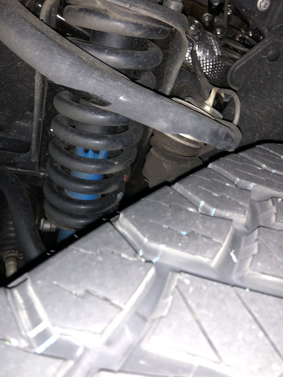

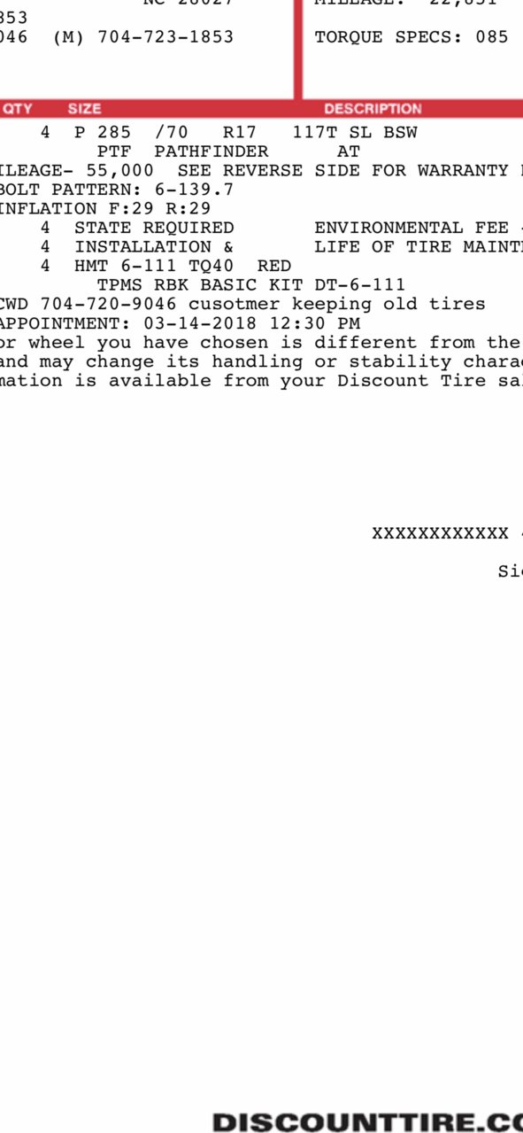

    i just upgraded my tires to 285/70/17 and have some rubbing on the uca at full lock. Oddly, it is worse in reverse but still there either direction. Based on reading a thread about a guy running 255/85/16 on a stock 16 off-road I was looking to swap to 255/80/17 which should be the same size. I have the 16 sport model so here are my questions:
    Would we have the same stock wheel specs? I would assume but can’t confirm?
    If the uca appears to hit the top of the tire at full lock, is the solution slight lift or wheel spacers or both?
    Will the slightly skinnier and taller (roughly 1/2 in thinner and taller) make a substantial difference?
    Thanks in advance. I’ve read a bunch of threads but can’t find anything specific at the moment and I need to either confirm or change my tire order in the morning.

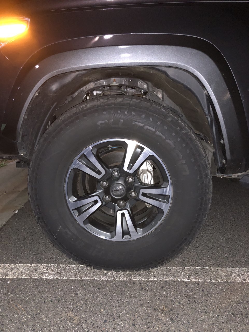

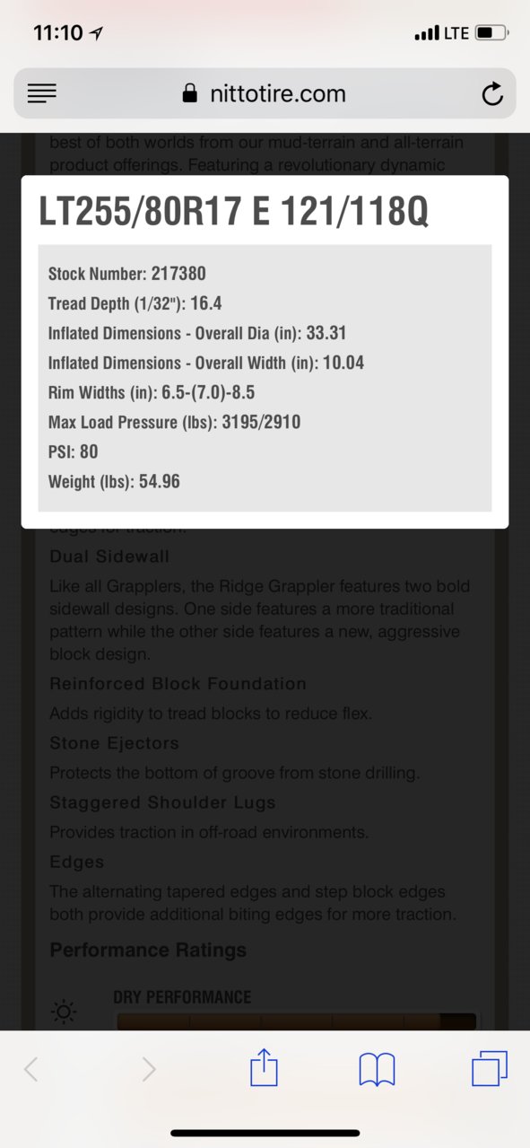

    Attached is the invoice for what I currently have as well as pics of what I was planning to get. A9CE0B04-DB5F-4315-A0E3-3894F3737EBF.jpg55562DD4-7185-43A6-993C-8012D1ED43DB.jpg 8F881E65-5137-4355-AFBF-791C93950483.jpg

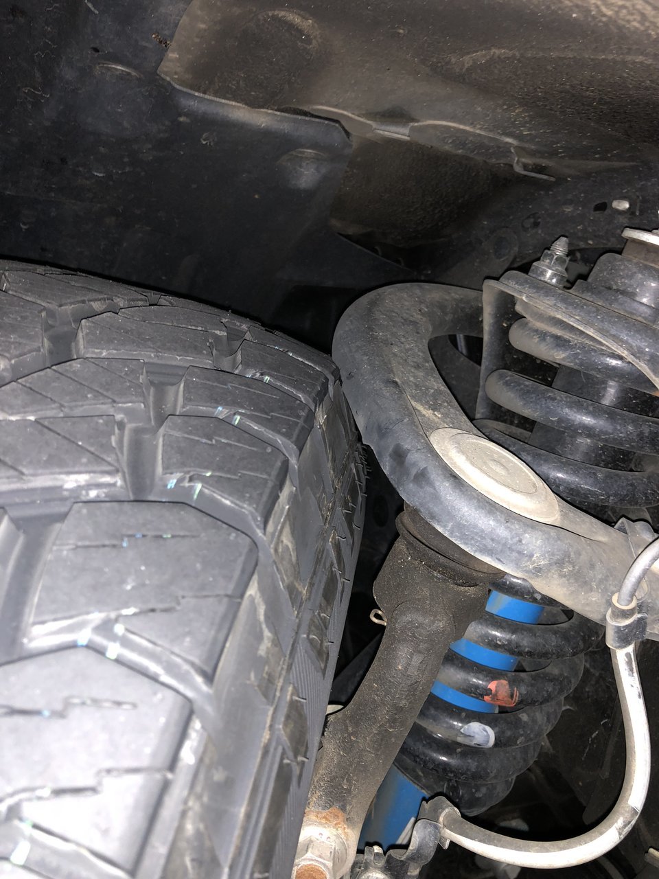

    image.jpg 5A64FDA2-4D37-437B-A8A0-DC709C79BEF0.jpg And here are pics of the rub. Both are of the driver front at full lock right and leftAACCB967-0059-47F5-9606-3A894E44079D.jpg

    And I get I can’t make more room for the tire in the wheel well, I guess I am more interested in the easiest way to change the relationship between the tire and uca...

    Sport is a 17x7.5 +30mm, 5.43" backspace
    Offroad is a 16x7 +25mm, 4.98" backspace
    A 3/4"spacer would give you 4.68" backspace, a 1" spacer 4.43" backspace and 1.25" spacer 4.18" backspace. I would go with the one that give just enough clearance. Your call...
    You might run into clearance at the mud flap/cab mount; more so with the larger spacer.
    If you go with 255/80/17s, it would get you 15mm clearance from the UCA. Is it enough? Again, your call.
    It would also give you 3/8" negative scrub radius. You would need wheel spacers if you choose to correct this. Again, I would go with just enough; the 3/4" wheel spacer. The 15mm tire clearance combined with 3/4" wheel spacer would for sure give you enough UCA clearance. It will poke about 1/2" more than stock; you might have mudflap clearance problems, but will avoid cab mount clearance problems.
