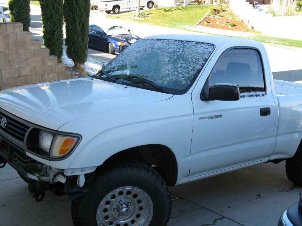

    My truck with the fabtech lift still on

    The picture above is when I had the 3" lift from fabtech. It consisted of fabtech Uca coils and shocks. I hated it and installed that Downey kit you have later on. I just wanted to show a picture of my old truck

    Tc cross shafts are way beefier for sure but I kinda Mickey moused it to fit. Tc arms are wider so I used three washers on each side to make up the difference
