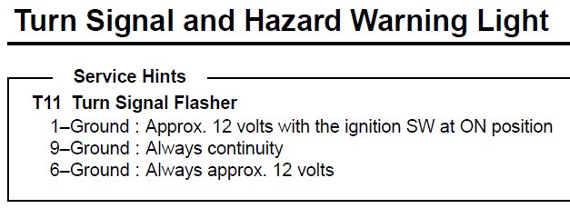

    1 = Pink
    9 = White with Black stripe
    6 = Black with Yellow stripe
    Multimeter on connector still attached to Signal Relay...

    Thanks but where is that plug located in the truck? Also, I should be measuring voltage at 1 and 6 and continuity at 9? What should the resistance be for blinkers to work properly?

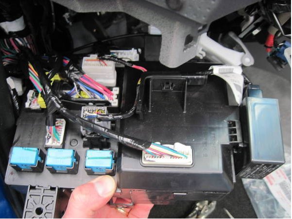

    Right side of cab fuse box, you'll need to remove the Driver's side "under dash".
    Box on the left is the flasher relay where T11 is connected.
