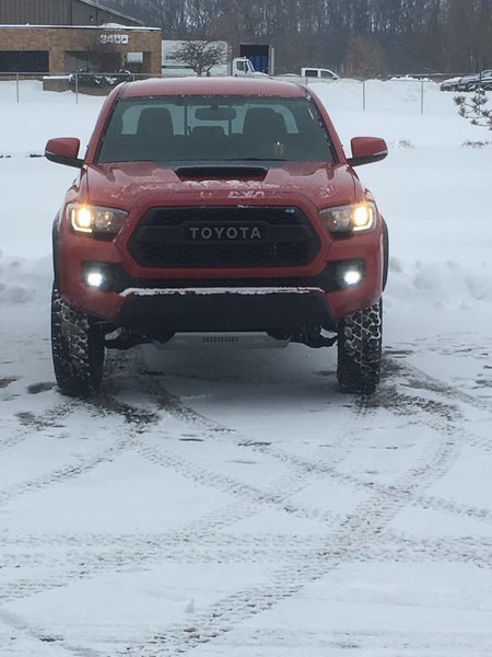

  13. Jul 29, 2019 at 4:04 PM
    Bonsai Tacoma
    Bonsai Tacoma [OP] Member
    Jul 29, 2019
    #300628
    8
    Flagstaff, AZ
    2019 Quicksand Tacoma TRD
