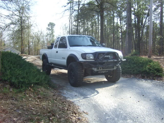

    SAS 01 TRD 4x4
    Look at build!
    You dont have to have an aal :eek:
    Ive got nothing but stock component under my rear and it rides just like an AAl imo untill i can afford a new pack and the rear is about 1" higher than the front which is hte same as a 3" exp pack iirc.

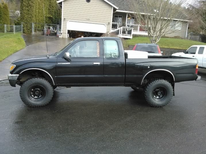

    1996 SR5 Tacoma. 33x10.5 Kevlar 3in lift
    This is 3 blocks in the back and like 2.5 up front? But its Revtek and was only $230!!! and another $110 for shocks in the rear. You dont need front ones

    ^^ Hows the axle wrap and ride with those spacers :rolleyes:
    You know you pretty much just spent the same amount as it would have cost you to get billies and eibachs right, or even just billies at 2.5 & a AAL right?

    Rides better than it did. No more bottoming out. Im 19 so really i could give a Shht less how it rides haha!
    But i got it from my job
