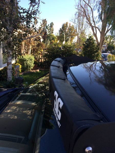

    I've got a wrap around, neoprene, Velcro cover.
    Had terrible wind noise/whistle that was fixed with this.

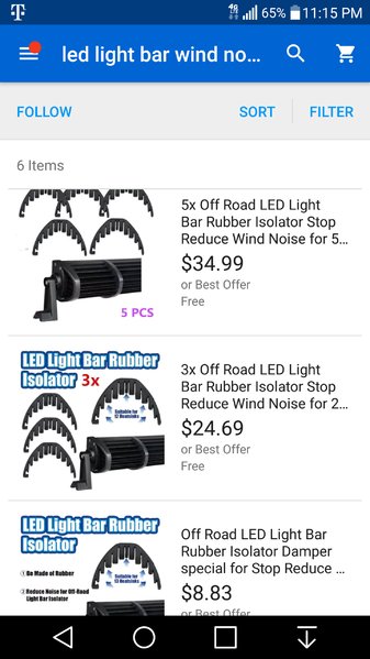

    I've also seen some rubber type isolators that come with bars. They're like a vertical strip of rubber with tabs that insert into the fins. I've only seen them on eBay with generic/random bars and haven't looked to see if there's any for sale by themselves. I'll search later.

    Found them on eBay by searching "led light bar wind noise"

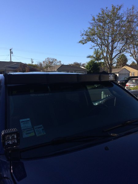

    It's a little longer than the bar, so it hangs over...
    I'm happy with it and it cut down almost all road noise and protects the lense from sun and road hazard damage.
