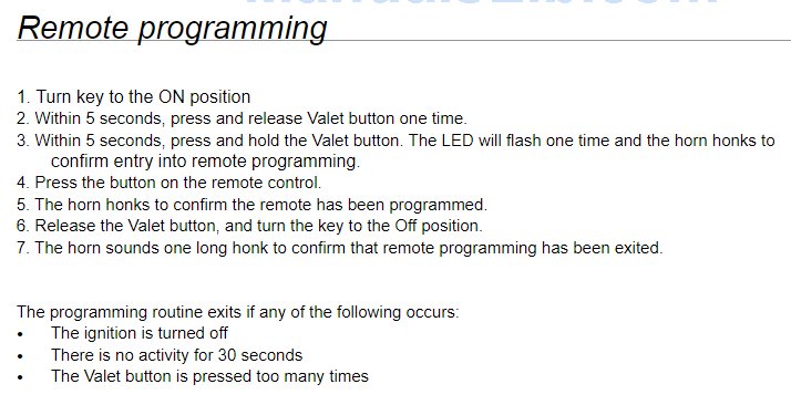

    I am assuming the valet button is the black on under the dash coming from the box its self correct? And by "button" is that referring to the engine start button on the remote?
    Edit - I just got it into to mode and it did all the honks ect just like it states however still no dice with starting

    yes, you need to program the DEI system to learn the physical key freq, i'm trying to find instructions..
