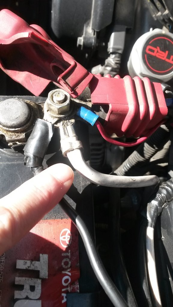

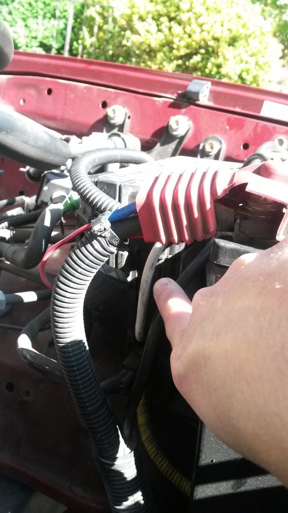

    Hey guys and gals! Need your advice/expertise. I purchased a yellow Optima battery recently. I have successfully lengthened the grounding wire to accomodate the terminal locations on the new battery, but now I'm finding I need to add length to another wire. It is the 6ga white wire leading from the positive terminal to the base of the factory fuse box. Does anyone know where I can find more of this wire? I've looked for a week with very little success. Your help is appreciated!

    home depot and lowes sell wire by the foot. or you can just go to a best buy or a stereo shop and buy some. install bay in best buy will probably have scrap that they can throw you or sell. it will probably be 4 ga but that is thicker and better if its a power wire

    Doesn't matter what color, it's a positive wire so pick a color that is associated with it. Welding wire works good too

    there is different kinds and grades of wire but as for color they come in all different sorts. yes the main reason for white would be for identification. if you want keep it "factory" then yes but if you or a mechanic are needing to work on it HOPEFULLY they can figure and trace the wire to what it is

    you just need a multi strand power wire that is ofc and can handle the current load. typical amp power will work fine. just DONT go smaller

    Just pick up fine strand copper of equal or greater gauge. Heavy/thick strand isn't very flexible. There is 0 reason to concern yourself with ofc unless you get a sense of pride in installing the only 18" of magic wire in your truck. Insulation color doesn't matter except in visual
    id. However anyone who should be playing with wire will know that anything between your battery + and fuse box is hot. Generally red, yellow, white, and anything with a white stripe is suspect and treated as hot until tested otherwise.
    If you go aluminum, quick rule of thumb is to go 1 size heavier. If you're doing really long runs do the actual math.
