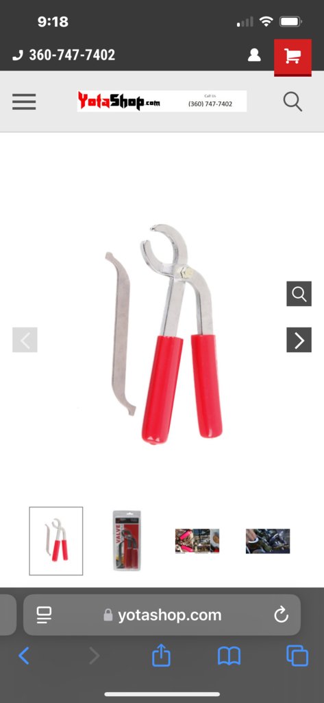

    As you guys probably know the Schley tool is not being made anymore. Does anyone know if the tool offered by yotaahop is worth the money? I dont mind paying for tools so if there is a better tool out there let me know. I’m going throw the kitchen sink at it.

    I found it easier to just use 2 screwdrivers. I bought the Schley Tool and tried to use it and found it to be more of a hassle than 2 screwdrivers. Gave it away to another TW member that was adamant he would need it to do the valve jobs.

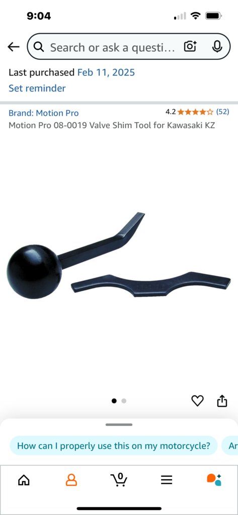

    I used this one on the cylinder near the firewall. It requires you to push against the cam lobe, so I suggest putting something in between. https://amzn.to/3SuTUZR

    IMG_4995.png Well I have finally gotten around to doing the valve job. I purchased the tool set from yotoshop. that looks like this. I took the pliers apart and just used the one side that rotates on the bottom of cam. Take the little tool that holds the bucket down and hammer it out another half a mm longer. This half plier will do most of the valves until you get to the 4th cylinder. The very back exhaust and intake valve’s against the firewall will need this little tool that looks like a bent screwdriver.. Just use the bent screwdriver to insert under cam to depress the bucket. Takes a little practice but something you catch on pretty quick. A tip I used::: I depressed bucket and place the bucket holder tool to keep bucket depressed. Now make sure you can rotate the shim. This will show that the tool holding down bucket isnt jammed up against shim. Now insert a small screwdriver or pick to break suction on shim to pop it up. Thats why after bucket is depressed and tool is holding bucket down you try and rotate the shim. The rotation of shim tells you it’s ready to be popped up. If shim doesn’t rotate it will never pop up. After a few tries it gets easier.
