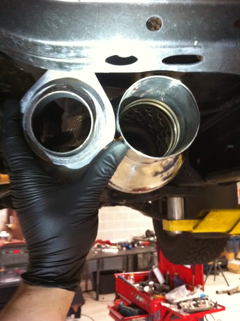

    Here is what I was talking about, to free up restriction. Now, this was done on the URD y-pipe. Same applies for the factory y-pipe.
    The catback exhaust that is factory, is 2.25" OD. If you install an aftermarket exhaust, it will be either 2.5" or 3" depending.
    Where each bank of the y-pipe comes together, it bottle neck right before it goes into the catback. Being that the URD y-pipe is a even 2.25" OD, mandrel bent, it is even more apparent the restriction before going into the Catback. Keep in mind, your exhaust is only as large as the smallest opening.
    Since the factory Y-pipe is of multiple sizes and not mandrel bent, there is even more restriction in it than the one in the URD Y.

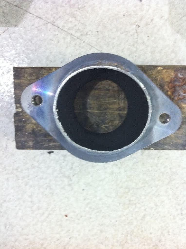

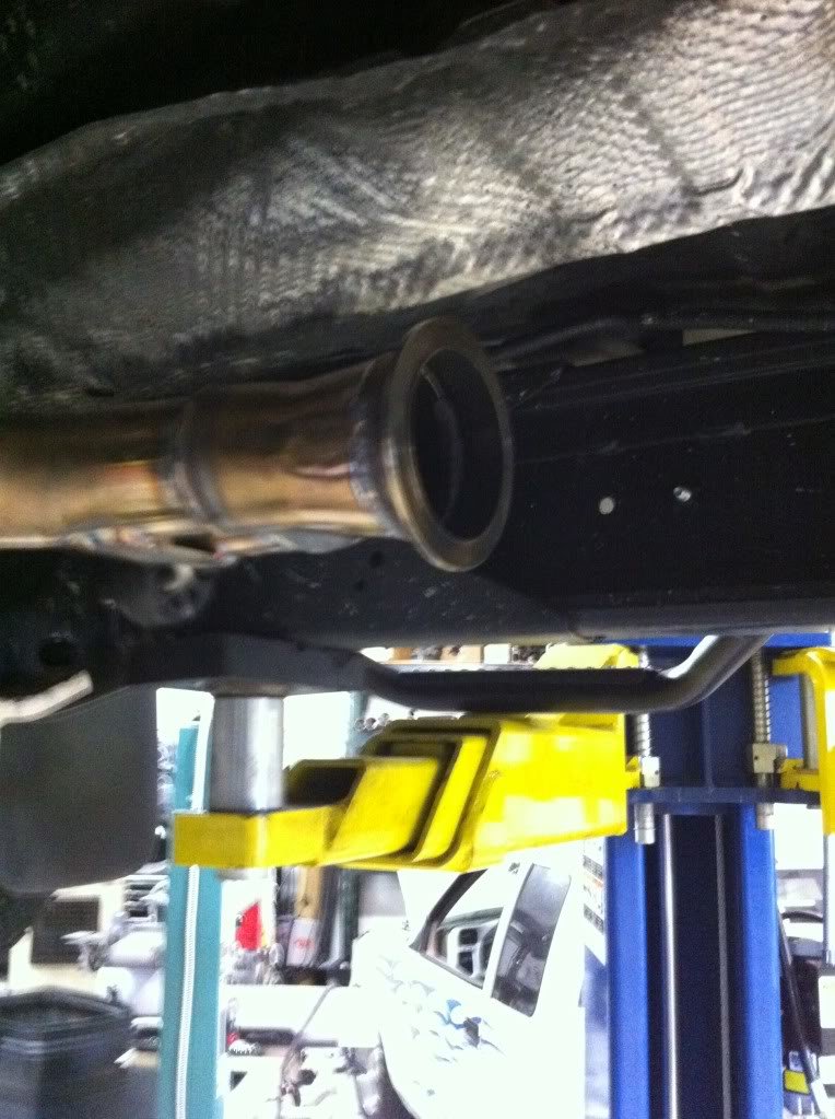

    Here is Toon's adaptation:
    You can see how it tapers smaller to the outlet, which is on the wood.
    Afterwards you can see how it is nice and equal in dimension, with a V-band flange on it.
    Here are the outlet size differences, between the flange that was cut off, and the exhaust now.

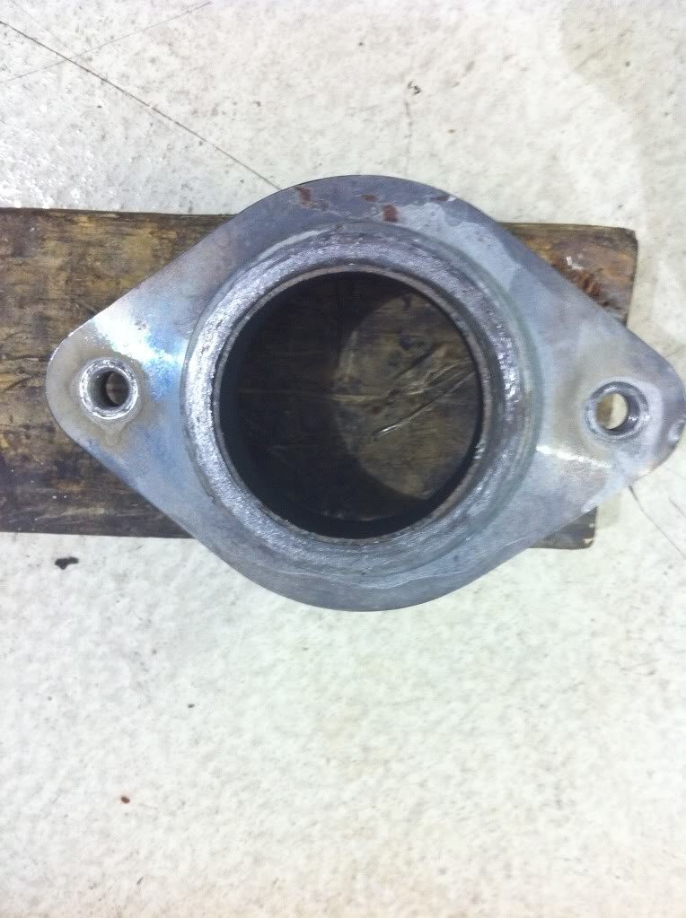

    Here is a good shot from Outlaw7's build.
    Comparing the two Y-pipes.
    You can still clearly see the restriction. Necessary on the URD Y-pipe, to maintaing its flexibility to mount to many different exhaust forms, including the factory one. Very smart actually.
    Some more shots of what he did to his URD Y.
    http://www.xr-underground.com/forum/showthread.php?t=46351
    It really does open up the flow. Like taking a restrictor out of the exhaust.

    If you're going to go through that much trouble to change the flange where it meets the cat-back pipe, why would you leave the standard-restricted flanges where the Y-pipe meets the header? :notsure:
    (also don't think I'd have the balls to cut up a $500 Y-pipe) :eek:
