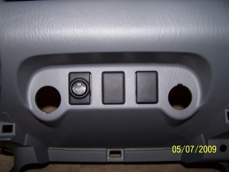

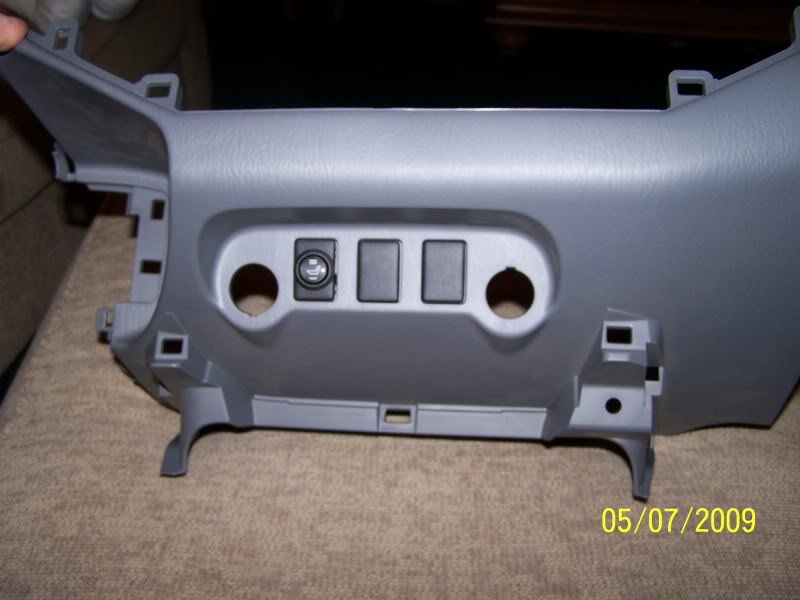

    I asked a few months ago if anyone wanted to trade a 2008 lower center dash piece with their 2009, unfortunately no one took me up on it. So I had to just buy the thing. It's not cheap, but I saved a few hundred lives the other day at work and they gave me a $100 bonus.
    I'm a perfectionist by nature and I don't like the drill a hole in the middle of your dash idea and put a gaudy looking switch there. I like it to look as it came from the factory.
    For the record a 2009 lower dash piece will fit a 2005-2008.
    Just throwing ideas out there for everyone!
    (I'm still waiting on the last blank cover)

    The total was like $105 to my door for the panel and the black inserts are just under $4.00 each. I just went through Conicelli Parts Center, as they were the cheapest I found.

    55407-04040-B0 is the panel
    55539-28160-C0 is the blank. They are sold individually

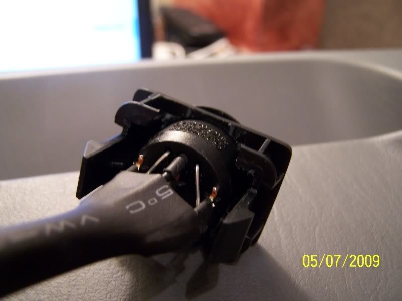

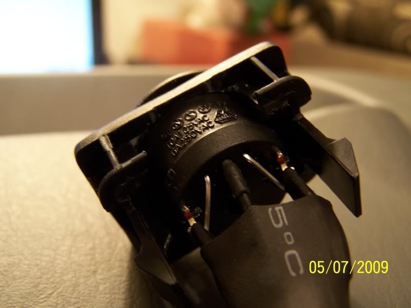

    I put a piece of masking tape over the front to protect it and be able to mark the center.
    Drilled a pilot hole in the center and used a step drill to ½" as the switch is .512" that was close enough to trim with a utility knife. Then I squared out the .75" height for the switch.
    Along with trimming all the excess off the back and still keep the locking tabs to hold it in, it took about an hour. It could probably have been done in less time, but I'm just anal about crap like that!

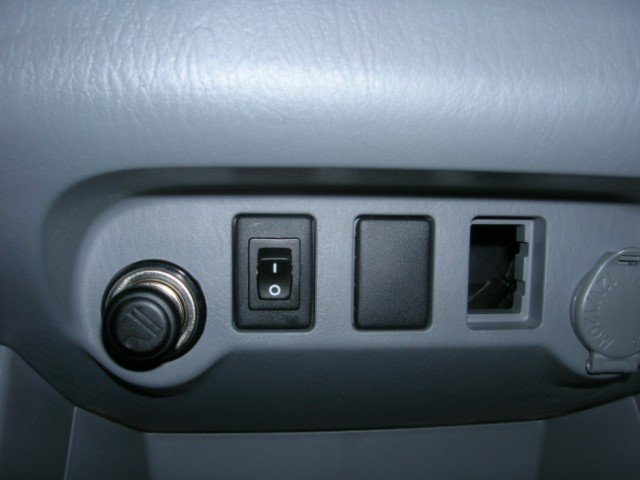

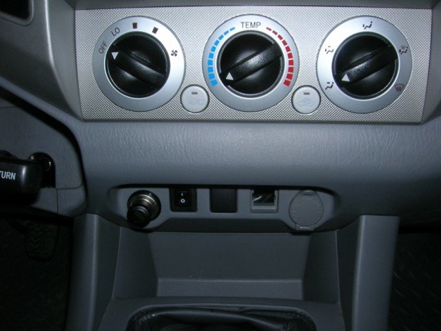

    I'm working on that same thing myself. I bought the lower panel from a member on here and got 3 blanks and I'm installing my seat heater switches in two of them. The third will probably be a rooftop light bar switch.
    It was quite a challenge getting the switch in there, not much material left after drilling with a uni-bit.
