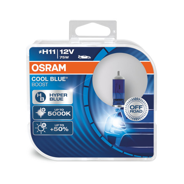

    Came across these, not sure if the housing can handle but the are 75w low beam standard is 55w and high beam are 65w.
