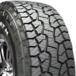

    I second this. I run the Hankook Dynapro ATM right now. Ran the Falkens before
    El Duderino[QUOTED] likes this.

    The Dynapros ATM do not get the credit they deserve. Last year, I spent 10 days winter wheeling with a guy on Dynapros in an older Tacoma with no LSD, no locker, no lift, and he went everywhere with total confidence. His traction in all conditions was impressive, from a tire that is not obviously aggressive. Unlike the K02s, they are actually siped, which I am sure helped on ice and snow. They are also supposed to be long wearing.
    I think when my K02s wear out I’m going to consider the Dynapros.
