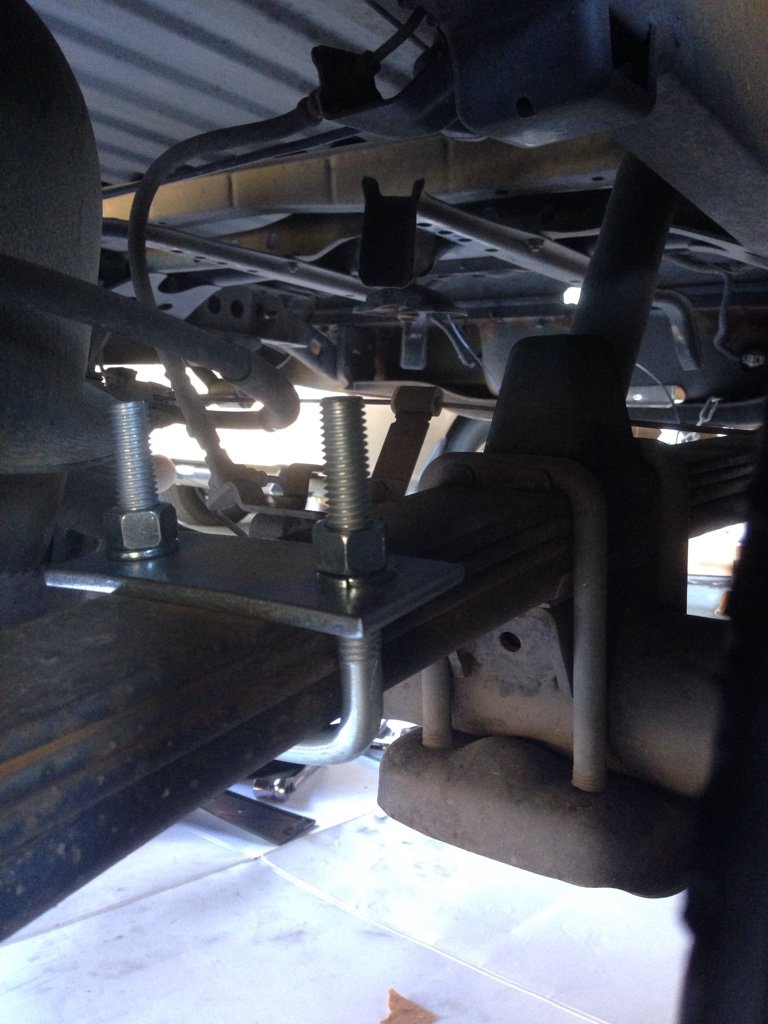

    Hope this works77ea8e7aad8bcf22f007f6e1315a40e3_b81607dc21ccc7fea89b4b66a0592e38bcf2a377.jpg

    If it does help and you leave them on I would suggest going to ACE or some other hardware store and buying some stainless nylock nuts.

    Jeezus, your leafs are frowning.. on both sides of bumpstops

    So the u bolt did reduce the axle wrap a little bit but not much, my leafs are too far gone for this band aid to fix it, im guessing. I took them off because im a little worried it could puncture the gas tank if it were to loosen up and creep forward
