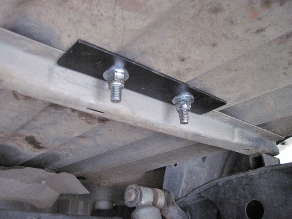

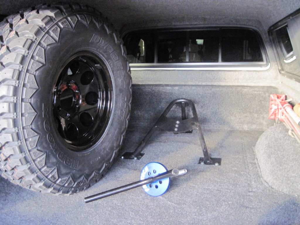

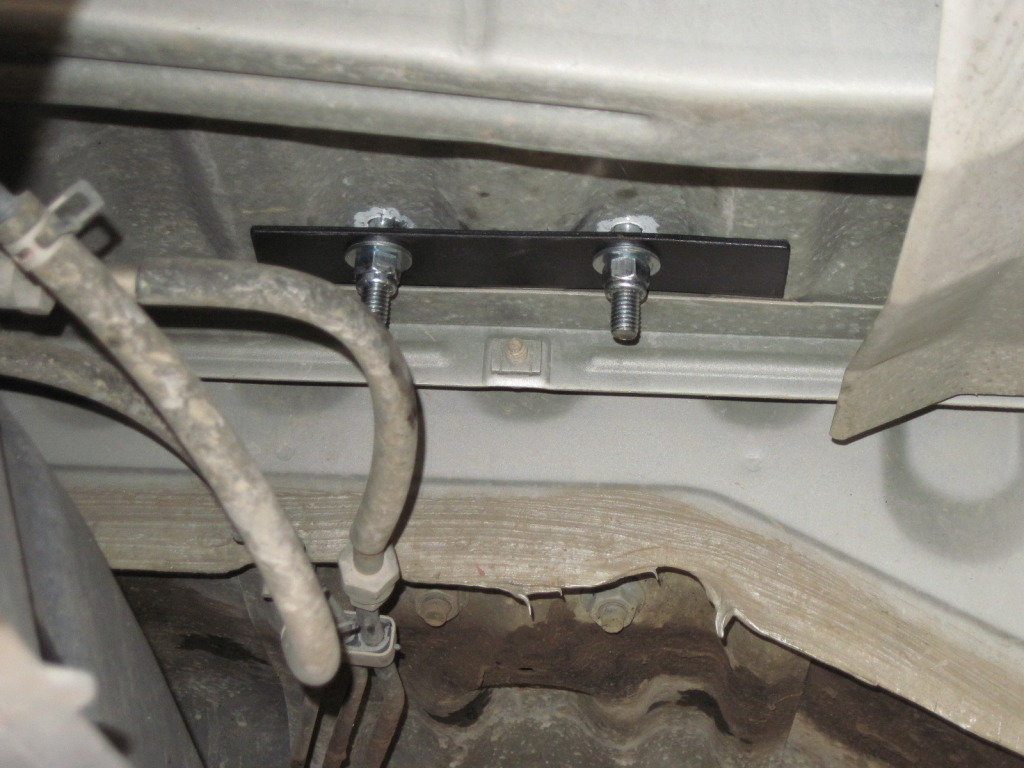

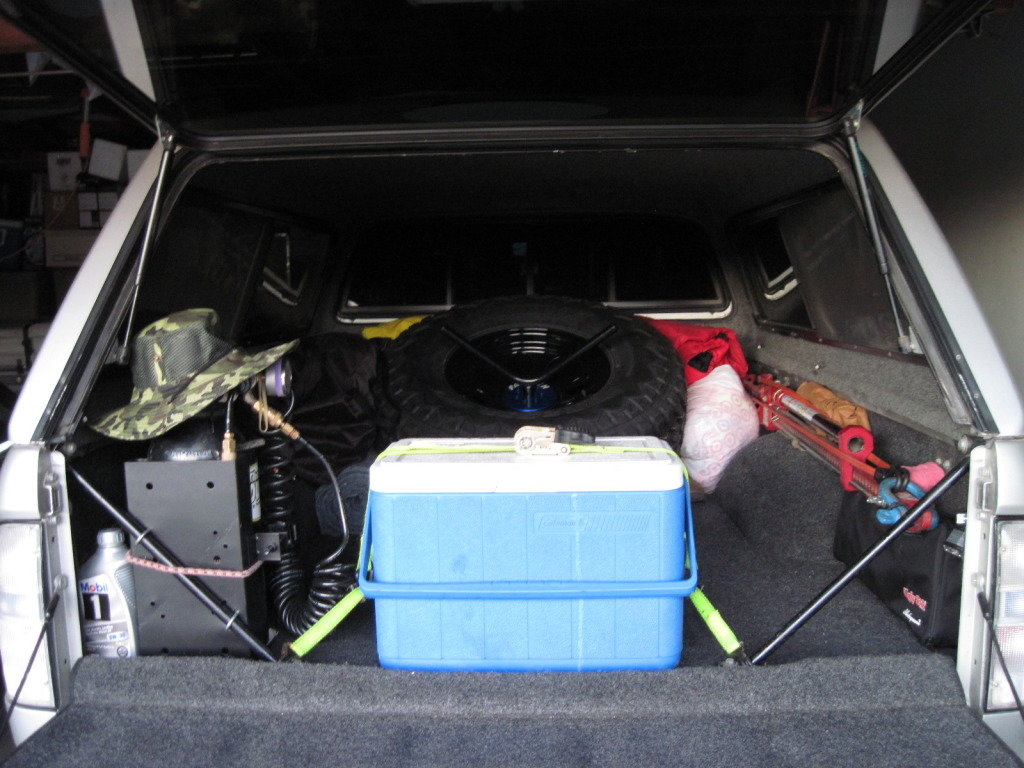

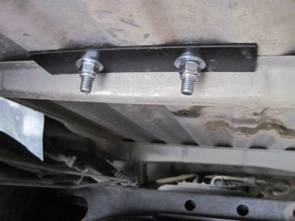

    Adequately thick, over sized backing plates will dismiss any real world concern.
    using bolts/washers only (without BP's)
    could pull thru or cause some metal deformation.
    backing plates aren't difficult to make...
    just be sure they span the bed's ribbing adequately.
    You can seal the mount holes from water intrusion if you wish.
    I simply painted mine to minimize any probable rusting.
    ...what those ^ plates support
    I am able to secure all of my recovery garb and tools...
    under and around the spare tire.
    including necessities needed to survive a few days on a trail.
    I still manage to have half a bed to fill up.
    But then... I usually load and haul a trailer as well.
