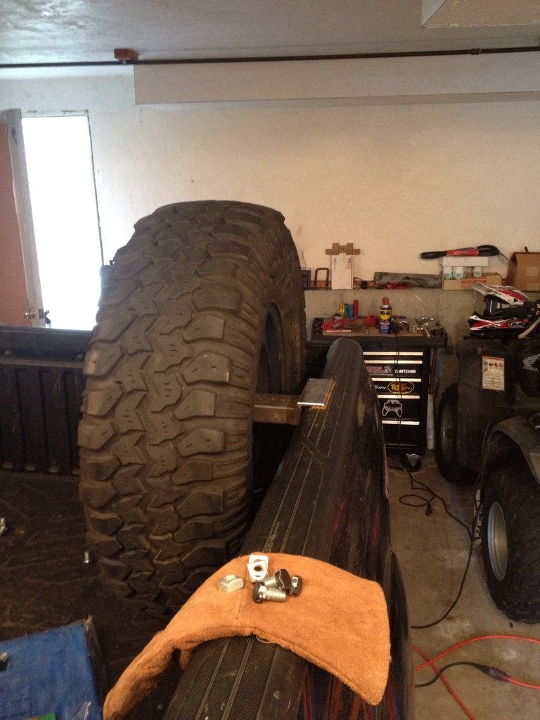

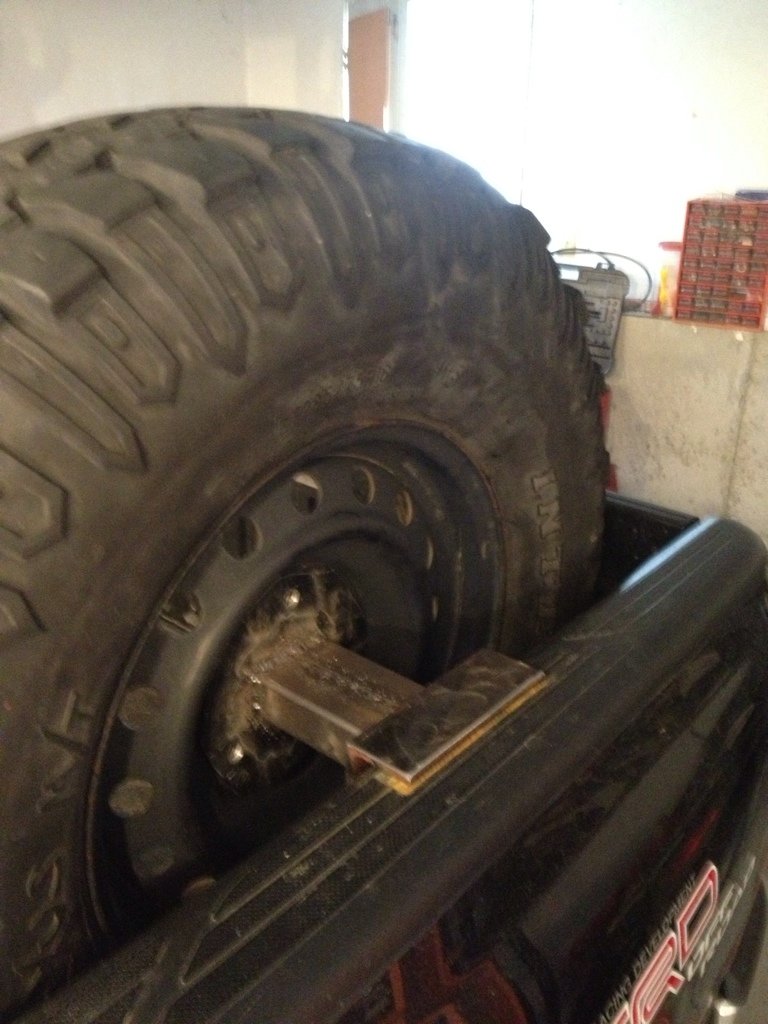

    Here's the few pics I had . It's basically scrap metal I had laying around my garage .
    Angle iron
    2 pieces of 2x2 square tube
    Plate steel .
    6234D229-5320-4AFE-A6A2-11A758CC80D6-266_52cf428b5535ac80fec37bb111ba73f42bea2eda.jpg
    1CFB4582-E4D0-453B-999F-46CB6544C142-266_1e0aaa40d31a73eba5e96db69a9f11a16b11f67f.jpg
    I don't use it anymore but I'm sure it's still somewhere in my garage . Ill find and take better pictures for you to get a idea . I had 2 1/2" bolts holding it to the bed rails .
