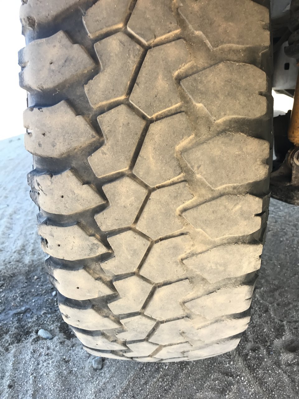

    How does that tire look?

    We rotated them after about 250 miles.
    I inflated the front tires to 48psi to get them to ride more on the middle of the tread. It also made it pull a little less.
