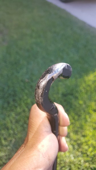

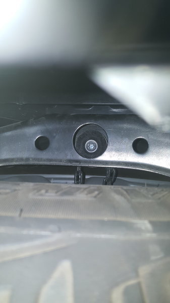

    Need help taking off spare tire from my understanding there's supposed to be something that the hook tool is supposed to attach to but this is all I see I've looked online and couldn't find any good video or instructions on the problem I'm having
    Thanks

    The hook end of the tool has flat spots that engages the splines in the round thig-a-ma-jig in the pic. Rotate counter clockwise to lower the spare........ Installation is the reverse of removal.

    That explained it very well thanks but this is what I'm dealing I'll just have a friend lend me there tool untill I get a new one cause Mines not catching whatever it is supposed to catch

    I'm not seeing why it won't work...... that should fit right in. The mechanism that lowers and raises the spare is an enclosed unit and should turn relatively easy.

    That almost looks like a wheel lock lug in there. o_O

    You have a spare tire lock on there. Unless you have the key for it you gonna have to grind/cut that off

    Look in the glove box. I know fords use a wheel lock type socket for their spares.

    What they said ^ There should be a lock-key that will fit onto the end of the rod in your picture. That lock-key will in turn fit into that 6-point star

    That hooked part is for raising/lowering your bottle jack, there should be another tool in the kit that connects to the spare tire to drop it down. A lock-key like mentioned above.
    In my '04, it came with a soft case under the rear seat that has a few rods in it that attach together to lower the spare. On one end of one of them there's the lock key, on the other is the hook that is used for the bottle jack.

    Yeah that's a wheel lock. Person you bought the truck from didn't want their spare getting swiped, I guess. There should be the socket that fits it in the glove compartment. Not sure if it'll fit on the end of the rods though.

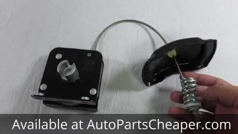

    This is what you are looking for. You have an aftermarket locking device on your spare tire winch.

    Just checked on the thread I think I've seen something like that I'll have to look around for it thanks everyone for the info yall really helped
