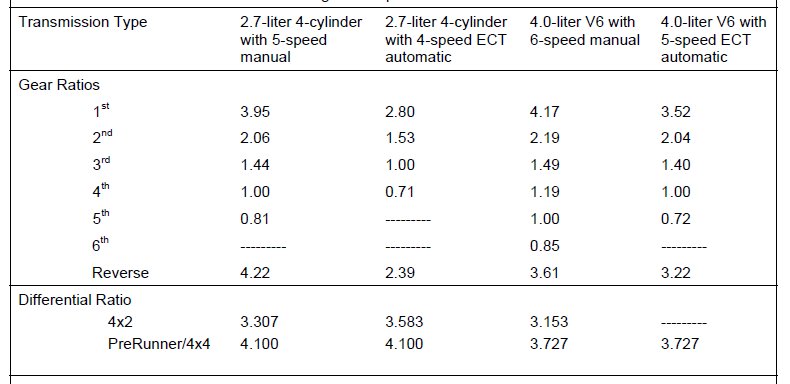

    Since we're talking about gear ratios
    2nd gen
