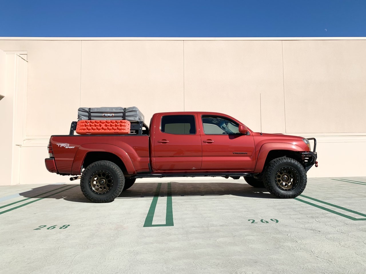

    It's time to retire my stock leaf packs + AAL and wanted to get some recommendation on a new set of leaf packs. Currently with a full load, the rear end sags way too much...
    My current setup:
    5100's w 887
    I keep the bedrack/rtt on all year long.
    I've heard of Allpro Standard/Expo kits and Dakars (Med)? Which one is best bang for your $?

    Maybe the icon leaf pack? Don’t know how people are liking it but you basically get everything you need to set them up for 3 different weight ranges. There’s an additional leaf that you can switch I and out.

    Icon Rxt over Dakars from personal experience.

    dakars for bang for buck, make sure to use RUBBER ISOLATORS between the leafs and keep up on the maintenance for the bushings or they wil squeak like a MF. i went with el095R medium duty pack and great on & offroad. if you save up a bit more go with deaver u402's, much quieter and easier articulation from my experience

    I'm swapping from ome HDs to Deaver stage 2s my vote Deaver.

    Vote... ICON!

    When upgrading to new leaf springs, I'll just need a new set of ubolts and that's it correct? Want to make sure I order everything at once.

    Yes you should need new ubolrs depending on overall leaf thickness. Highly recommended the archive garage U-Bolt flip kit with new bump stops.

    Okay i just wanna say that with my fiberglass shell my dakar mediums got me 2.75 inches and then settled to get me 1 inch over stock (i was sagging 1 inch below stock height before the install.
    just fyi with that rack and rtt the dakar mediums will probably net you 1 inch over stock height. Not necessarily a bad thing. And they’re not super stiff so that’s awesome
