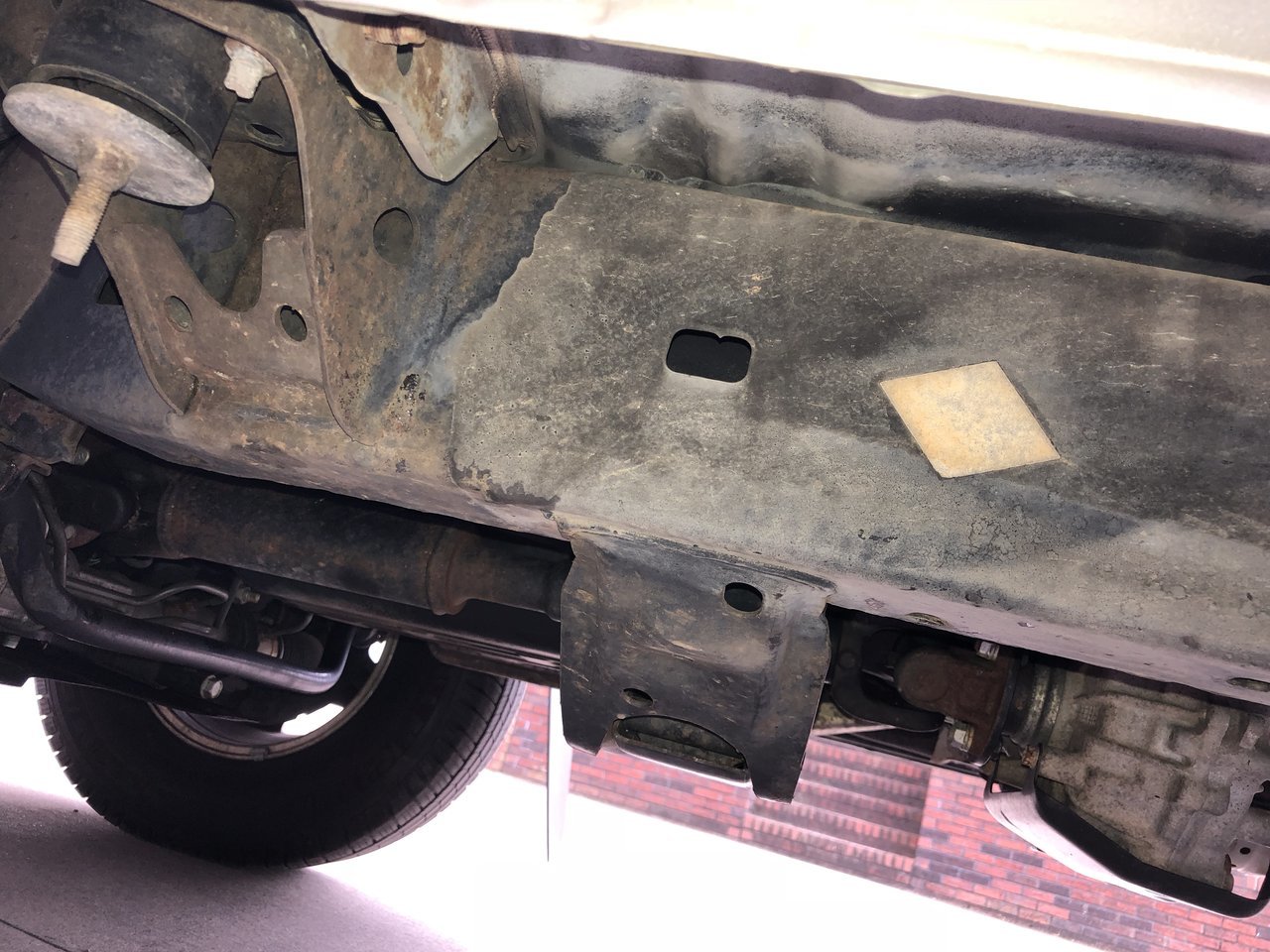

    I’m considering getting a Tacoma for a daily and giving my old fj62 a much needed rest. I’m looking at a Tacoma and need some advice on the frame. I’m not too familiar with Tacoma’s so my question is, do 1st gens have a diamond shape in the frame? Or is this patchwork? Seller says the frame has never had work but it doesn’t look stock.

    That frame looks fine, at least that section, it has very little surface rust. My sons 2001 DC 4x4 has the same diamond painted on it. What does the rest of the frame look like? Check the back close to the leaf spring attach points, and around the spare tire carrier.

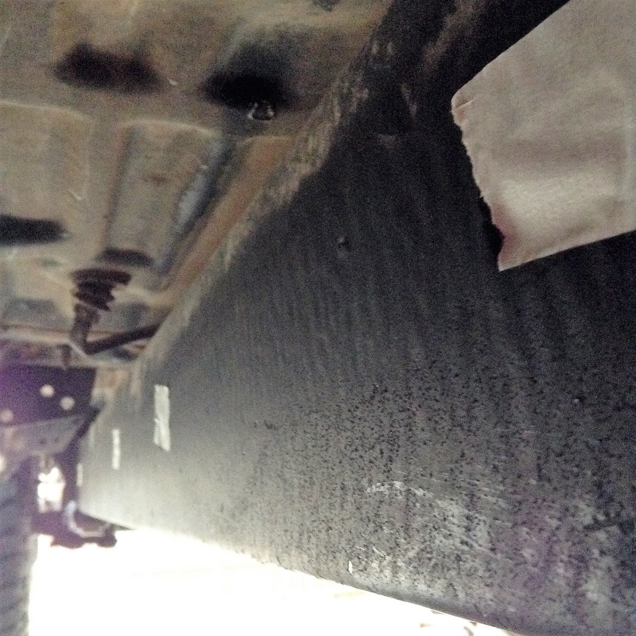

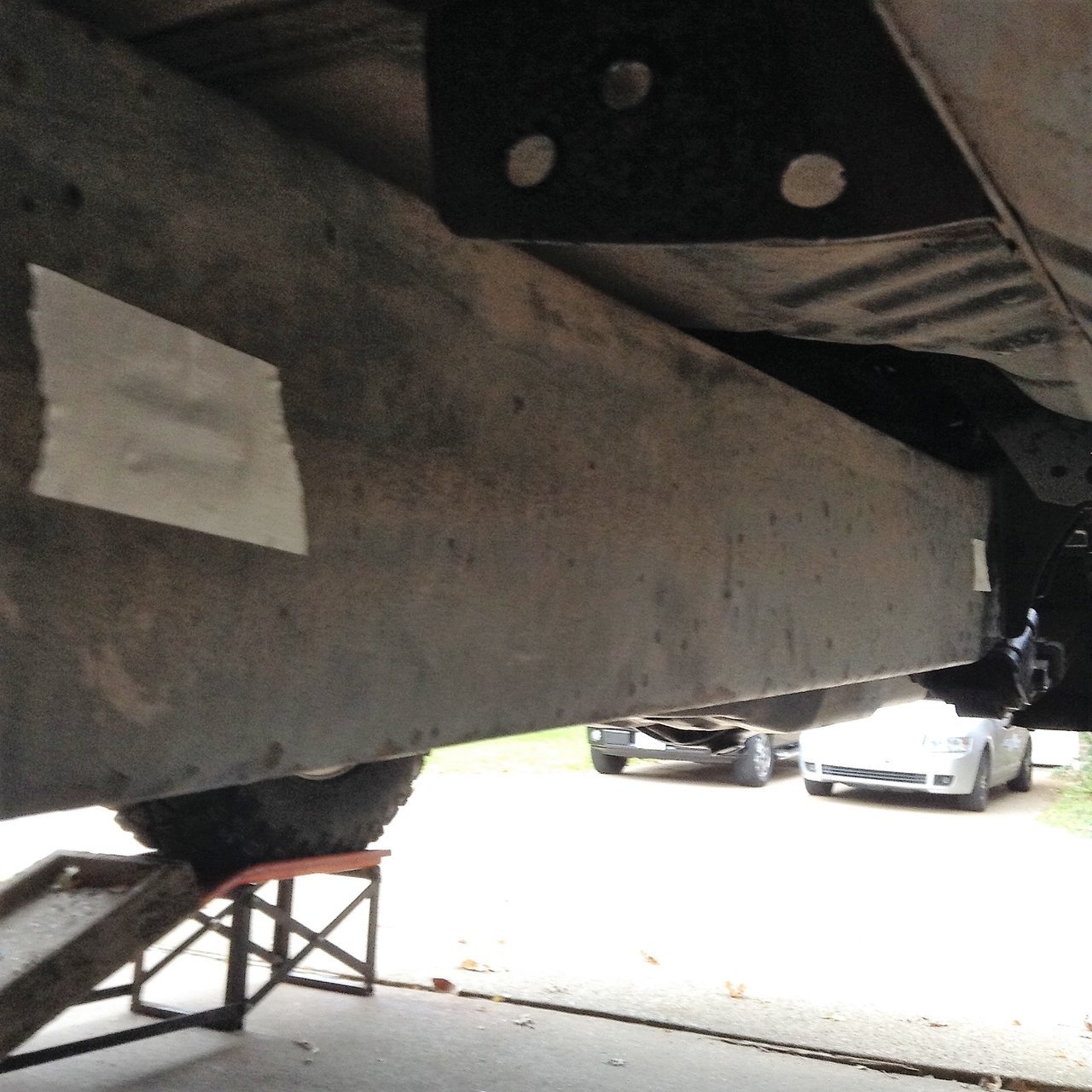

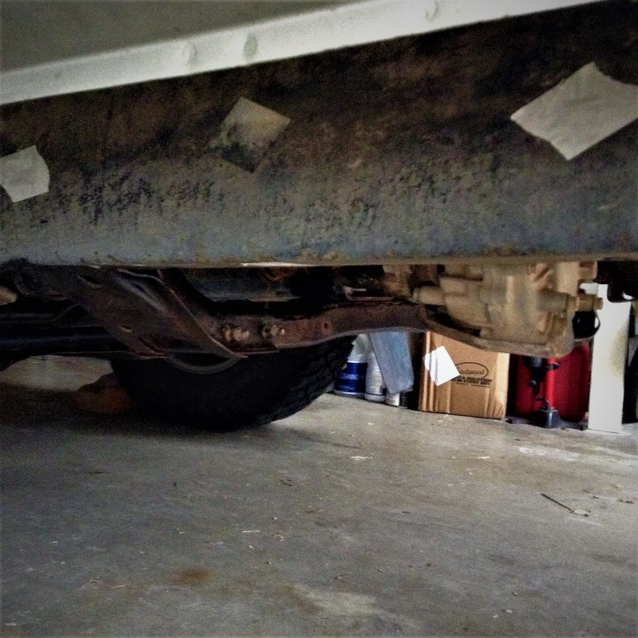

    I think I saw something similar on mine when I was applying the rust treatment... one of the pics :
    looks like cellulitis lol.. but once you remove that layer is just clean frame, mine I realized was sprayed later on while I was working on it, got more pics but like they said , hammer it since rust grows from inside out on these frames

    That looks like it. I wonder what the diamonds represent. If anything

    aren't those stickers? or are they actual chunks of metal?

    Lighter colored paint on the one I looked at today.

    I think the diamond \romboid shape was on it, the other are just painter tape since I was covering all the wholes to paint the frame internally first
