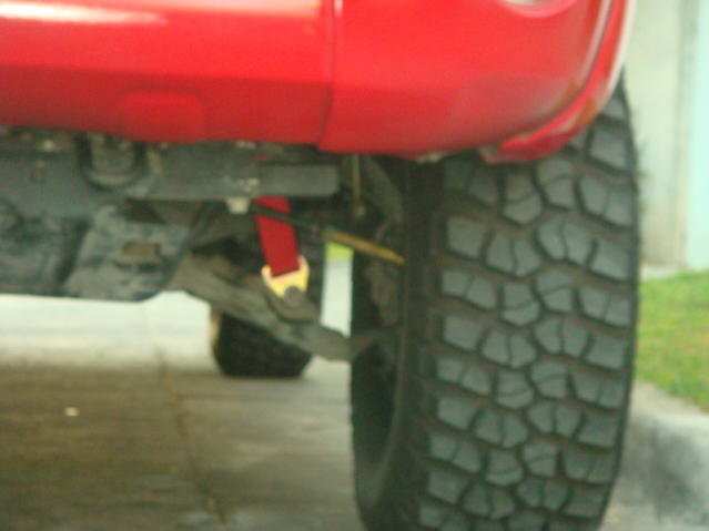

    Heres some pics of the truck with the 40inches front

    looks goodm why are you running limit straps, i have only seen that on long travel trucks like mine.
