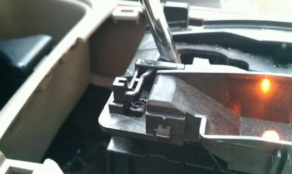

    the spring for the shift lock lever came off and i cant find a way to put it back.:confused:

    Pictures? Not sure what spring you are referring to.

    Oh I see it. Hold on.

    I think your best bet is a long pair of needle nose pliers the are angled at the end. Compress the spring between the pliers and then slide it in.

    I assume this is where you are talking about but haven't heard back from you yet.

    Seems like any easy fix but I'm not taking mine apart to see, good luck OP.

    thanks man but i got an 04 i think i got it
