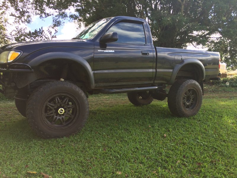

    Some pics of the truck would help.

    IMG_0351.jpg .

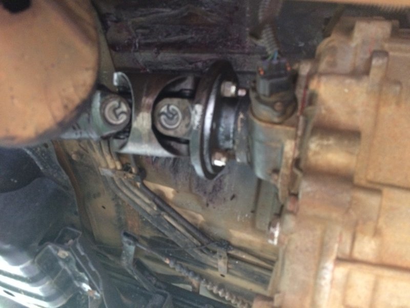

  5. Apr 15, 2017 at 5:48 AM

    Just noticed this,
    the good news is you don't need a new drvshft you need a new mechanic,
    the part you need is called a constant velocity joint consisting of two u-joints with a centering ball between them which should be able to be purchased over the counter and installed.
