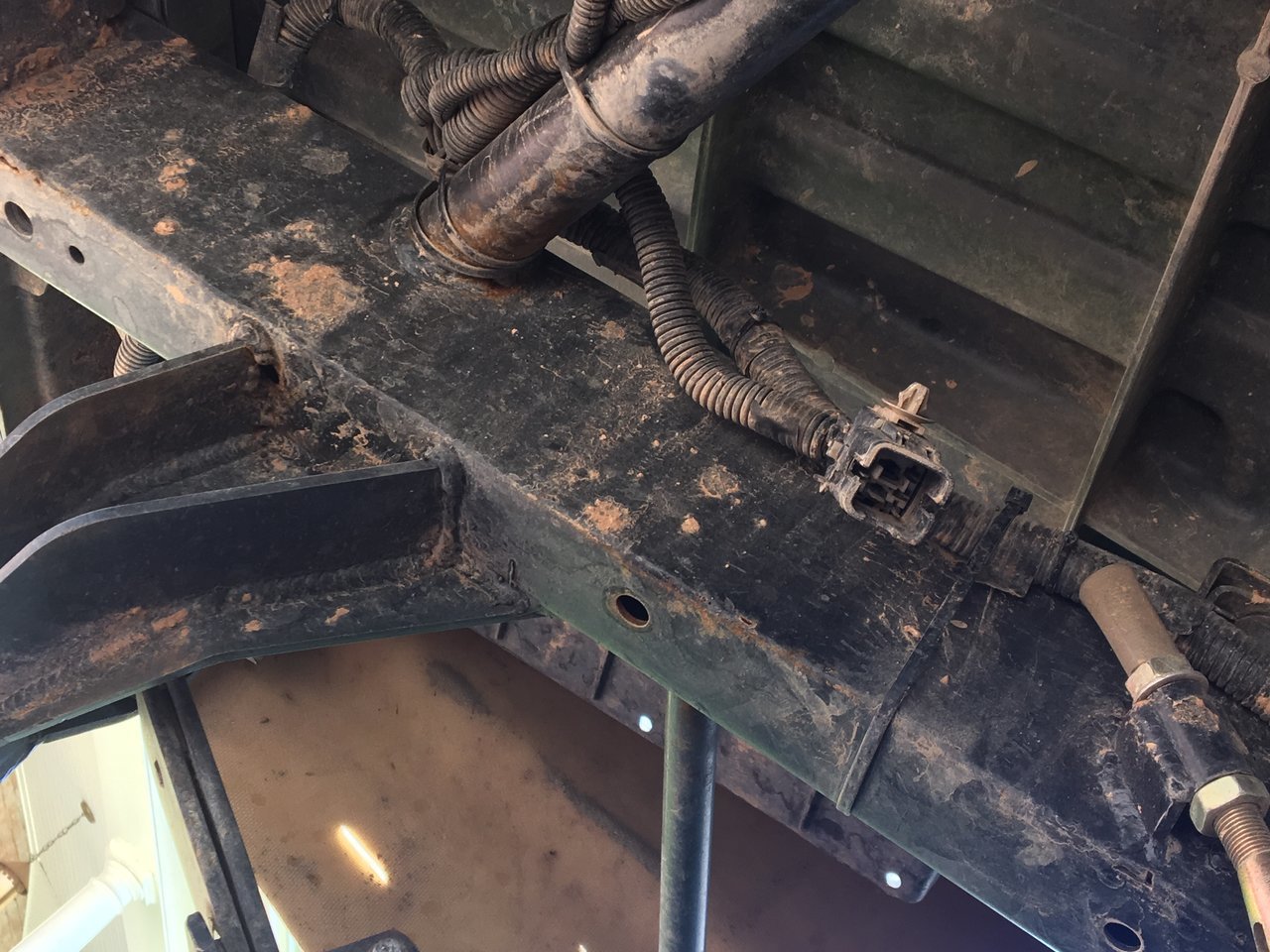

    I have a 2007 tacoma prerunner v6 2wd. There is an aftermarket rear bumper on it so the stock hitch and bumper were removed. There is a plug (pictured) that looks to possibly be apart of the stock wiring system for towing. Im trying to get a 7 pin connector installed on my truck and need some help with what steps or product i need to purchase. Thanks!

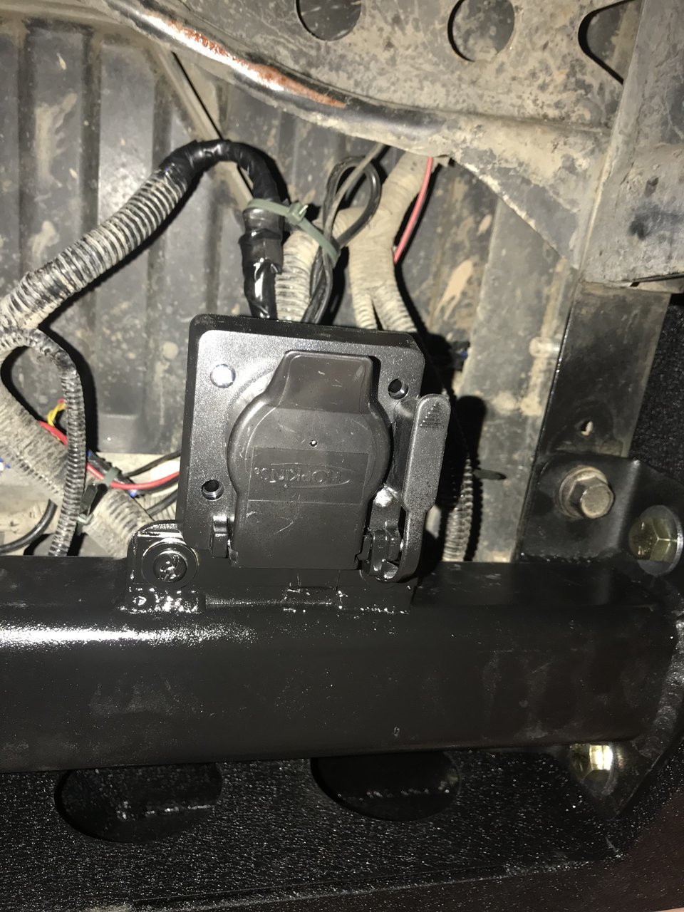

    Mines busted off too
    Gonna splice in a aftermarket one

    15$ and it’s in and works fine
