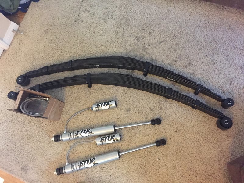

    Just an update for you...I just received my order in this week (minus the bump stops...should be coming in next week) as soon as I get the time to install I'll post up a review. Shouldn't be much longer hopefully! Pic for the wait

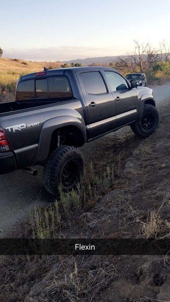

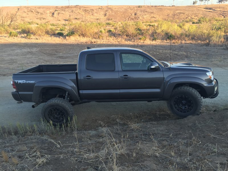

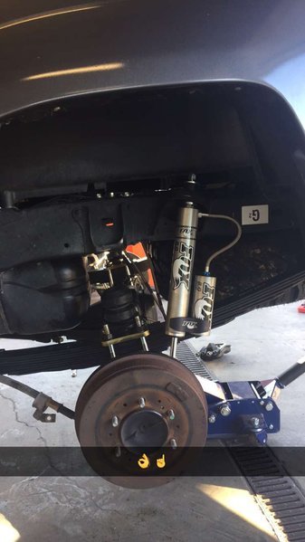

    Finally got the ALLPRO kit installed. The ride on an empty bed is great can't wait to mash this thing on the dunes. The timbren bumpstops I got with the kit also work great with the fox 2.0's. The lift I got in the rear actually didn't give as much rake as I thought so I left my front the same (fox 2.5's) and I think I will leave it as is for now so when I load the bed it will even out. Overall happy with the kit rides great and definitely gained some more flex in the rear. Any more questions let me know.
    Edit: I'll post pics of the full truck so you can see the rake as soon as I can. Don't have any in my phone at the moment. It wasn't bad imo and actually would prefer a little rake for when you carry a load. Also the fox shocks I'm running aren't offered in the kit options on allpro website for some reason. I'm running part # 985-26-117 shocks. Rated for 2-3" lift.

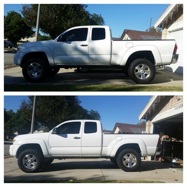

    I installed my AP standard pack this past Saturday, today was my 3rd day commuting 18 miles to work on the freeway. These make me realize how soft my stock + AAL pack was, the AP's are stiffer but much more controlled. Im sure some of that comes from the new Icon 2.0 remote resi's that replaced 5100's. I compare it to going from a clapped out 93 Cadillac to a 2016 M3. Stiff isn't the right word, I call it taut, as it actually feels good & under more control. Have only hauled a few pounds of air around so I can't elaborate on their ride under load. Now to figure out this driveshaft vibe....
