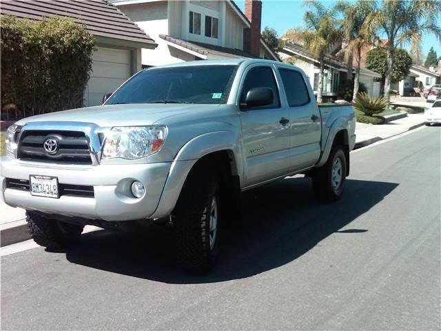

    Finally got the bilsteins and tires on the truck. Before getting the 285 bfg's I asked them if they could test fit them and they rubbed a lot so I went with the 265's. I took it to the desert over the weekend and really like the ride! There are a couple things I don't like from the mods I have done. My truck, although aligned after the bilstein install, still feels like it pulls to the left a little. Also, the steering doesn't feel as responsive as it was, it seems to have a little more play in the steering wheel. What do you all think is going on here?

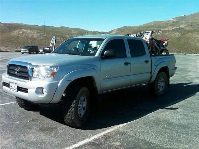

    Here is a pic from yesterday at Gorman, CA.

    post a thread in the so cal section next time so we can get a group together and head out there. was it crowded?

    Yeah there were a lot of people there yesterday. Probably because a lot of schools are on spring break. Next time I'll definitely put a post up before going. I didn't yesterday because it was kinda a last minute trip. Any two cents on how to fix my ride? I was reading that I may need to change the UCA's to correct the issues.

    double check the alignment numbers and make sure they are in spec. maybe get the wheels balanced. the truck is going to ride and drive different after a lift. it's just unavoidable. having the UCA's would be nice for added strength but if the truck alignes fine without them then they arn't really needed. they wont give you any extra travel unless you pair them with some ext length coilovers (icon, king...)
