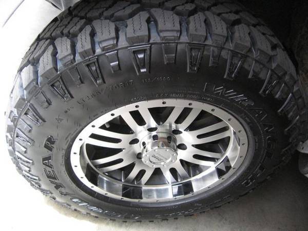

    My two cents... they are 265/70/R17
    Goodyear Wrangler Duratracs
