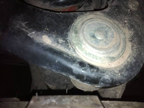

    HEY GUYS I HAVE A 2011 TOYOTA TACOMA WITH 3 IN LIFT AND 33'S BUT I ONLY HAVE NIT EVEN IN CLEARANCE ON

    i wheels rub above side wall of tire got a pic hold on

    On the UCAs?
    What's the backspacing of your wheels?

    GOT PIC ON PROFILE ON WHAT IAM TALKING ABOUT WAS WONDERING OF 1.25 wheel spacers with help that

    1.25s will push the wheels out too far. That would make the backspacing 3.75", and you would rub the fenders bad.
    A 1/2" spacer would work. But you would want longer studs if you do that.

    OP, that part is called the upper control arm, or UCA for short.

    thanks i ordered the 1.25 what about a 1 in

    Still going to be too much but you might be able to get it to work with some cutting. How wide are your wheels?

    do u think if i leave it the way it if there will be any problems in the long run

    33x12.50 mud grapplers

    I think with these in combo, you'll want the absolute smallest spacer possible to get you away from the uca. It's tough to fit tires that wide on a 3" lift in the first place. The more you push them out, the more you are going to have to cut.

    so you think there will be any problems later if i leave it as is

    If the tire is actually contacting the uca that is an issue you should address. The uca will damage the sidewall.
