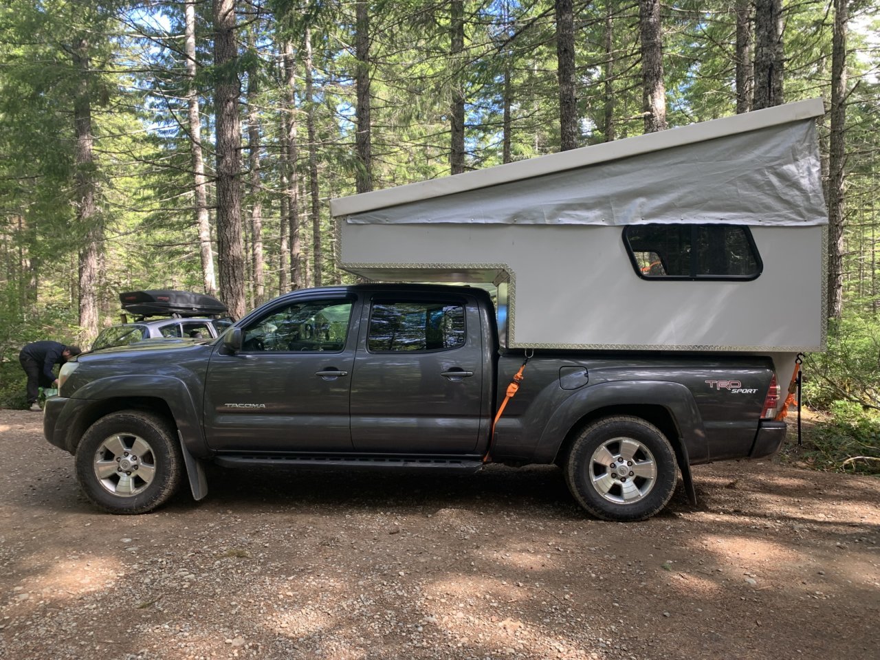

    I am looking for some advice on what to do for my suspension on my 2010 Tacoma. I have a homemade truck bed camper that weights approx 700lbs loaded. The truck has a stock suspension now, but it rides super low when it has the camper on. We will be using it in the winter to get up logging roads and access backcountry skiing. Any suggestions? Lift and suspension, or just airbags? Trying to keep cost down but want our truck to last forever! Located on Vancouver Island in BC. Thank you.

    If you don't want to lift the truck I would go fire stone air bags if you want to lift the truck and support that camper i would go with a dobinsons kit.
