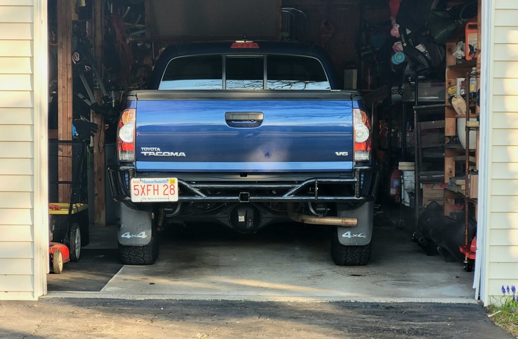

    i have this kit, the light just has two wires, no clips or harness to plug in anywhere
    currently my trailer plug is ziptied to undercarriage, and the two license plate wires as well from stock bumper

    here it is
