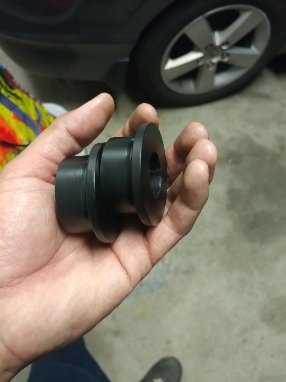

    Delrin bushings won't squeak like polyurethane... Delrin is a very quiet material, even when dry. It does not require lube but we use it to displace the water to prevent the pin from rotting inside. If you get anything with poly bushings, and you need them replaced with something better, there is a way

    Not just the bushings, the washers will squeak. It just adds to the squeaky leaf springs, lol.
