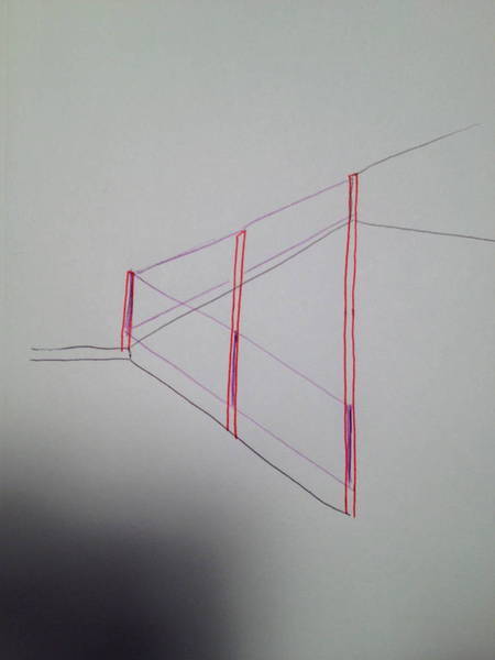

    here's what i was thinking. get three posts (red) that go from basement all the way to the appropriate height. put those posts between both stair runs, then secure the posts into the appropriate points as needed: existing wall at top, stairs, etc. make the center post removable and possibly the long one too. You could put them in with the lag screws as needed and not glue in the wood plugs. just leave them in with a friction fit. then build 4 panels of material of your choice (purple) mount them to the side of the three posts depending on the side of the stair run. this breaks down for big bulky objects but should be strong enough to catch a person when needed on occasion.
    i am not a professional, so this idea is at your own risk. the weakest point is potentially the post on the landing by the front door.

    Something like that was my idea. The hard part will be the center and the top though. The top is a hard part to attach it to. I'll get a picture of it in a second.

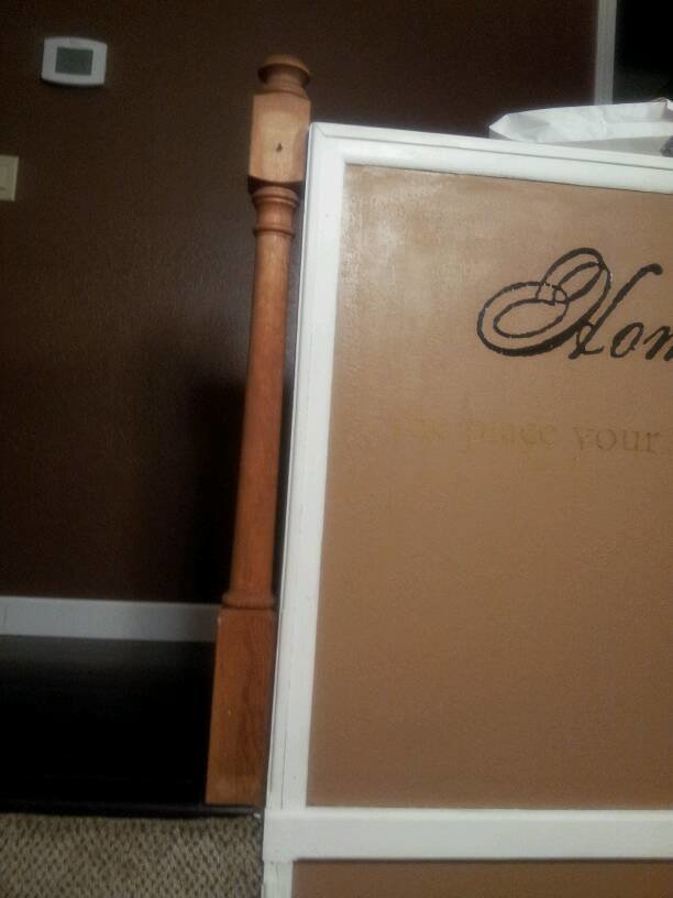

    This is the old post. Obviously doesn't work anymore. But I will have to find a way to anchor it into the wall.

    take that post out. carefully remove the trim. remove some of the drywall and reinforce that end 2x4 with another 2x4. then tie your new larger post into that after you patch up the drywall. depending on where you decide to put that post on the landing by the front door, you might be able to remove a piece of the flooring to patch the area on the top level after you remove the existing post.

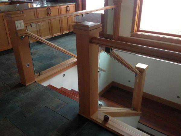

    I like that. And, if I tore out the wall upstairs, I could just do what they did on the bottom of the glass... It would take up the room of the existing wall.

    I built that railing

    What did you use on the bottom?

    The base that the flat glass is sitting on ?
    The whole railing system is made of vertical grain Fir

    Yeah. Man that looks nice. Not sure what it would look like next to dark bamboo though. Now I have a new project to look at for it. Guess I may be knocking out those walls.

    You could use whatever wood suits , but this is the design I was talking about

    That's a weird way to install clips though. Usually they are installed on the sides.

    I've only really seen top/bottom. I imagine you would want the clips to tie the handrail and glass together or the handrail would take a lot of flex.

    In this orientation they help to support the top rail
    Not weird
