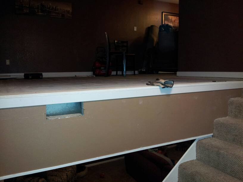

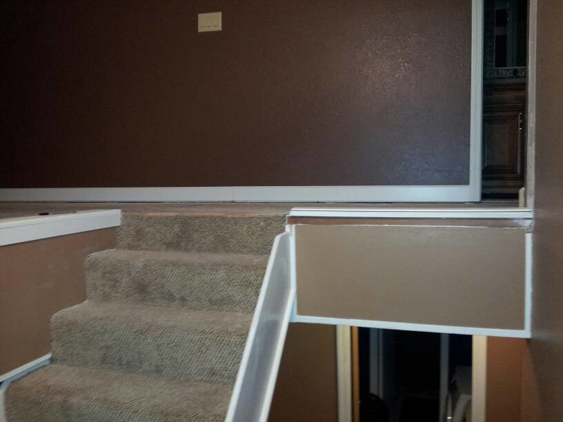

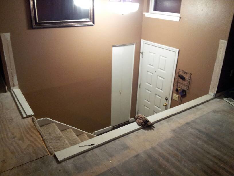

  18. Mar 2, 2013 at 6:03 PM
    #58
    Haslefre
    Haslefre [OP] Well-Known Member
    Jan 27, 2012
    #71523
    18,835
    Brady
    TN
    2019 Tundra
    Some flags and center console divider... lots of things on the wanted list.
    avutatu7_45997555ae8f3e294fcc6d2a2bfc705d9acd0adb.jpg7ybaza7a_aafa75628646a1693966d27a9fa176a8ab29f2b2.jpgu8yhehu9_774fbd89608c537dc45a3adacd07c708cfdc3074.jpg
    It has started
  19. Mar 2, 2013 at 6:32 PM
    #59
    Haslefre
    Jan 27, 2012
    #71523
    18,835
    Brady
    TN
    2019 Tundra
    That's the end of the progress until Monday. Carpet gets put down. Then awaiting tax return for the rest of the railing.
  20. Mar 2, 2013 at 6:34 PM
    #60
    OZ-T
    OZ-T I hate my neighbour
    Dec 15, 2009
    #27584
    50,579
    Peter North
    British Columbia
    You're gonna put the carpet down before the railing is mounted ? How is the edge being finished ?
