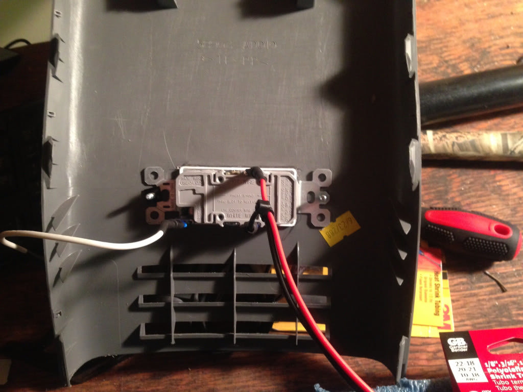

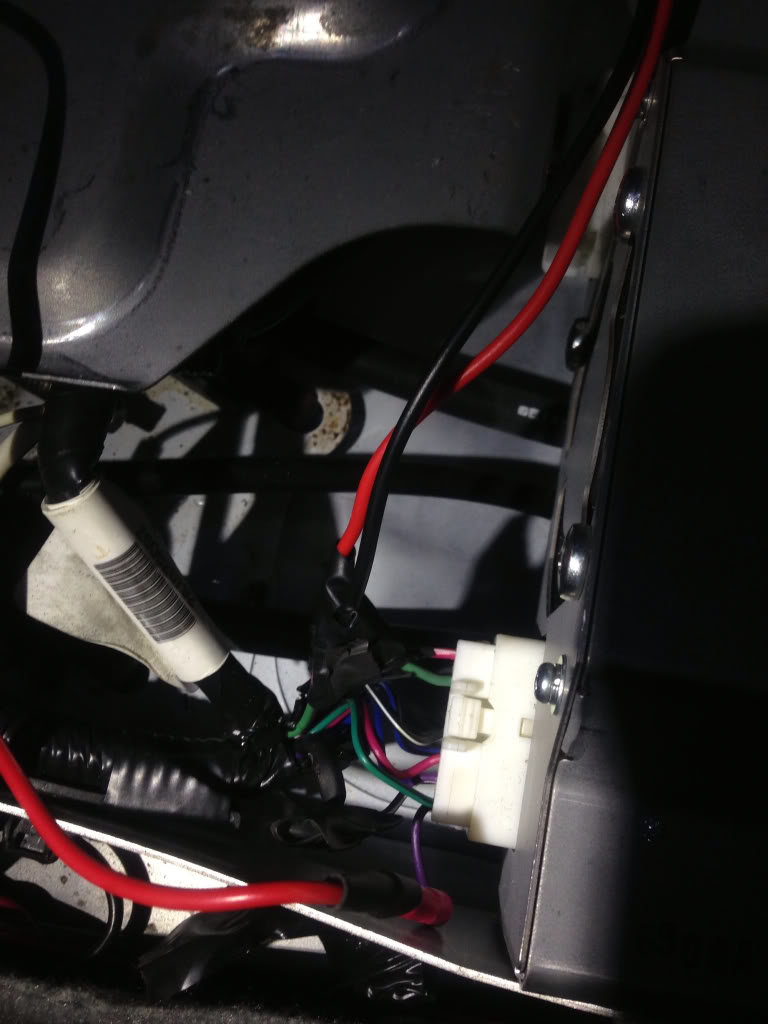

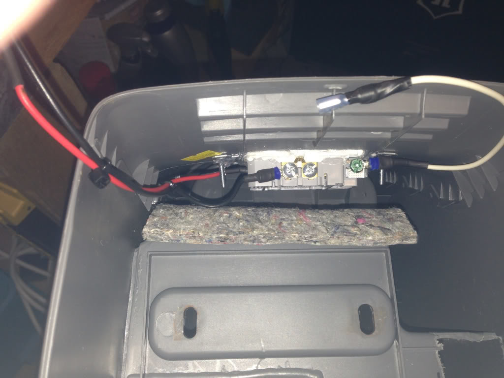

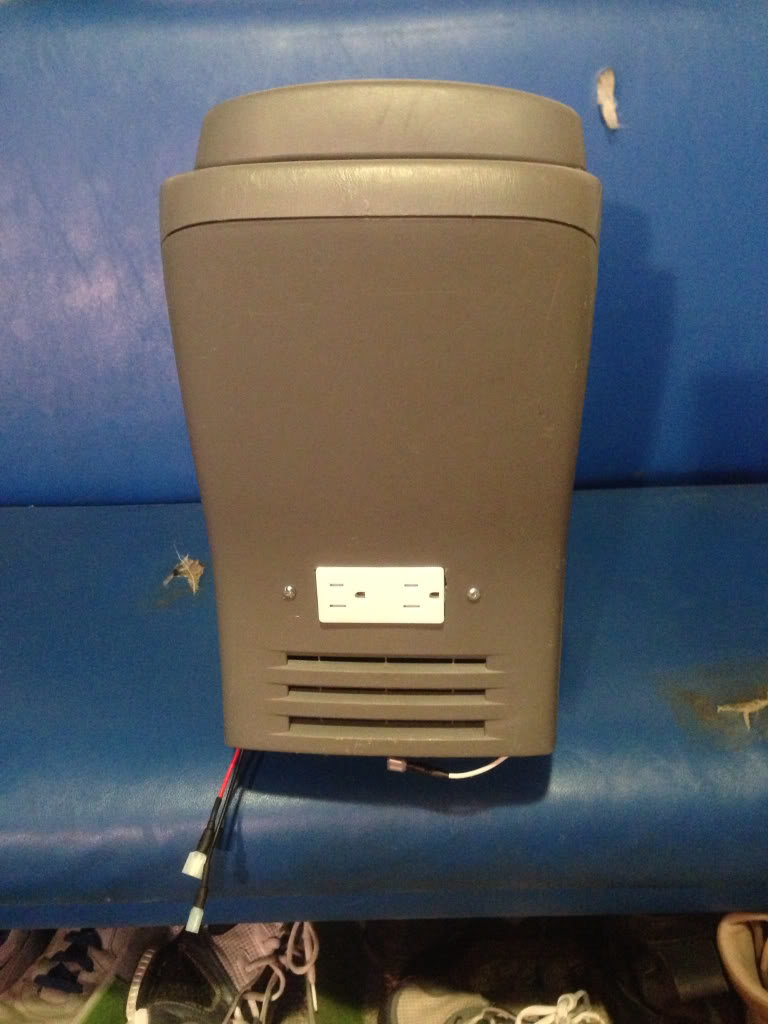

    This is what mine looked like after I got done with the 400w anything mod
