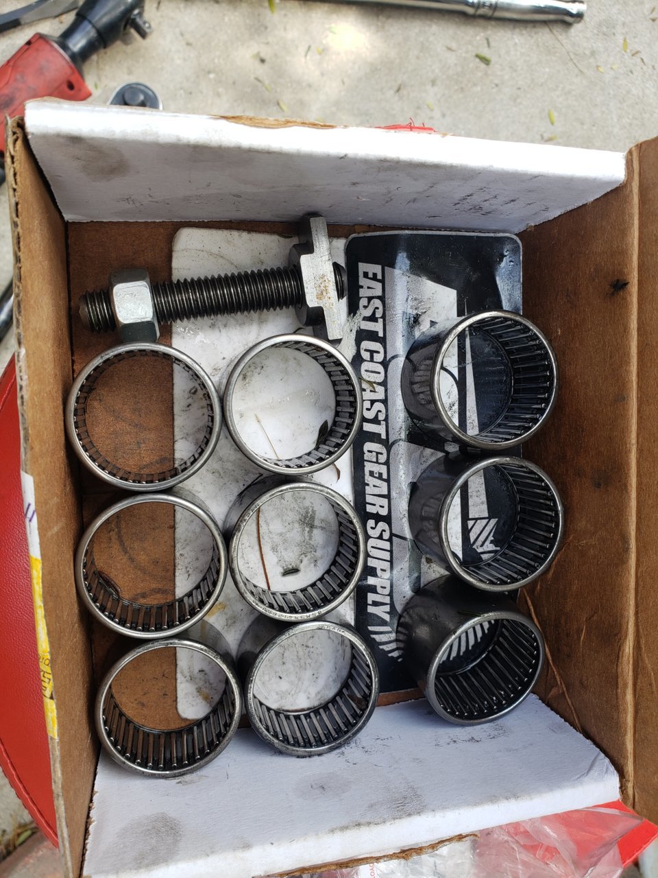

  14. Mar 21, 2021 at 2:10 PM
    #334
    thatrafael23
    thatrafael23 Active Member
    May 30, 2019
    #294865
    26
    Rafael
    Bay Area, California
    18’ Quicksand Taco
    Bilstein 5100's with 887 OME coils, JBA High Caster UCA, Method NV 16”
    thats how it was when I pulled the cv axle out
