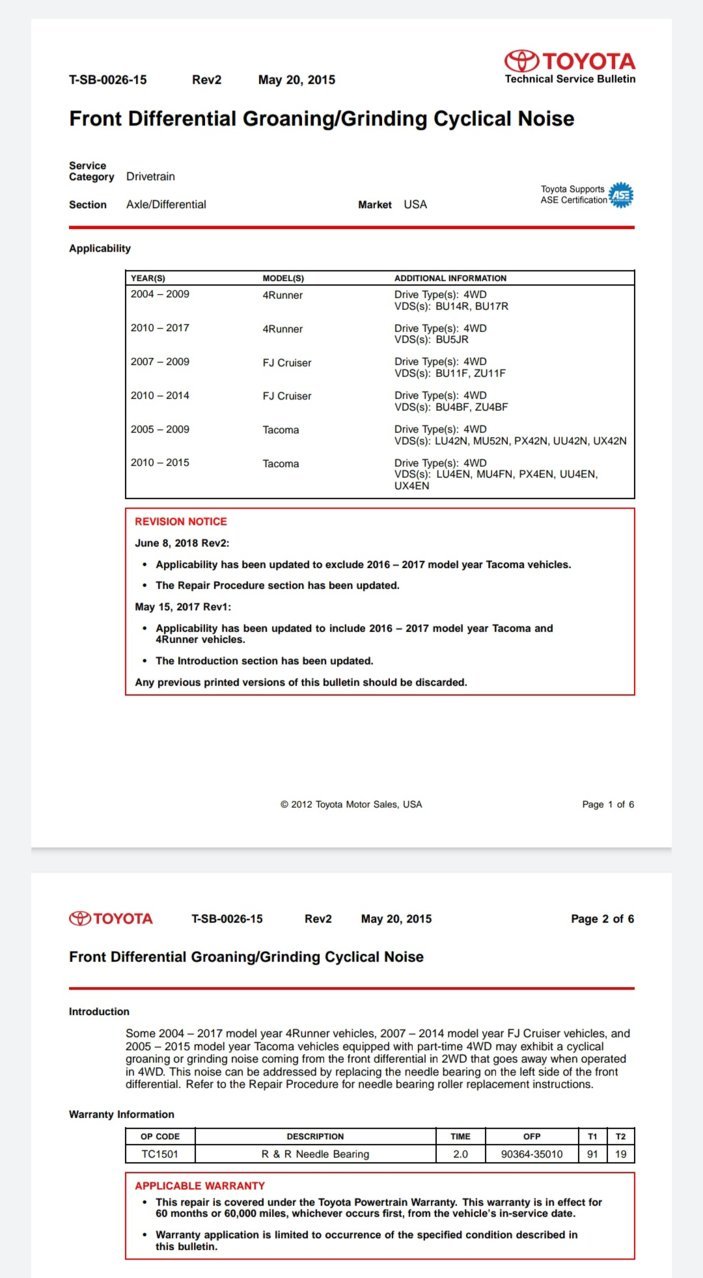

    The added lift changes the geometry of the front CV axles. Triggering bad vibrations. It also happens on stock trucks. There is a TSB for certain years.
    71tattooguy likes this.

    For 3rd gen or 2nd gen tsb? Probably for pro version though because of factory lift?

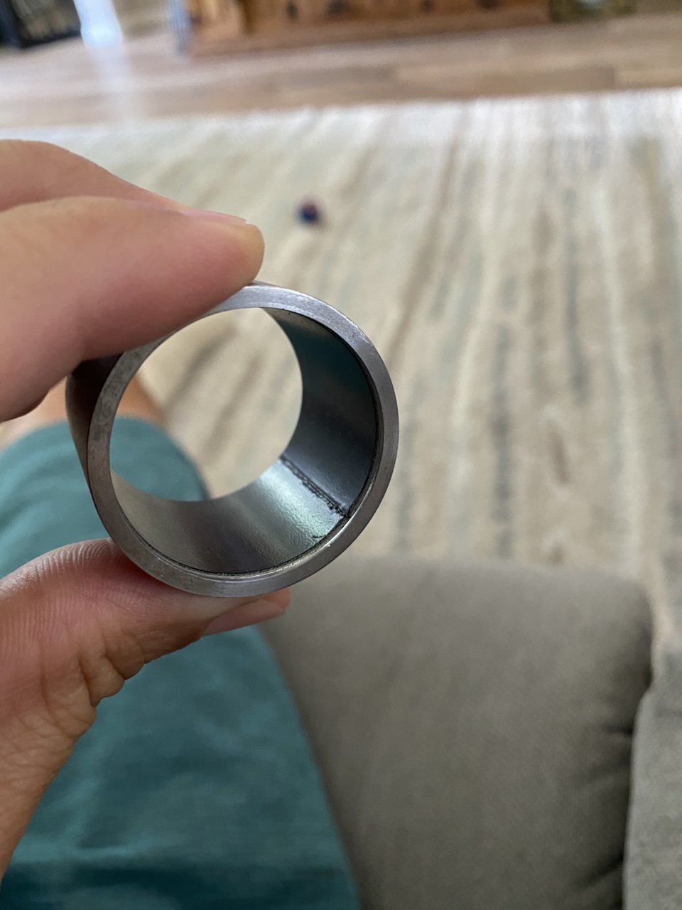

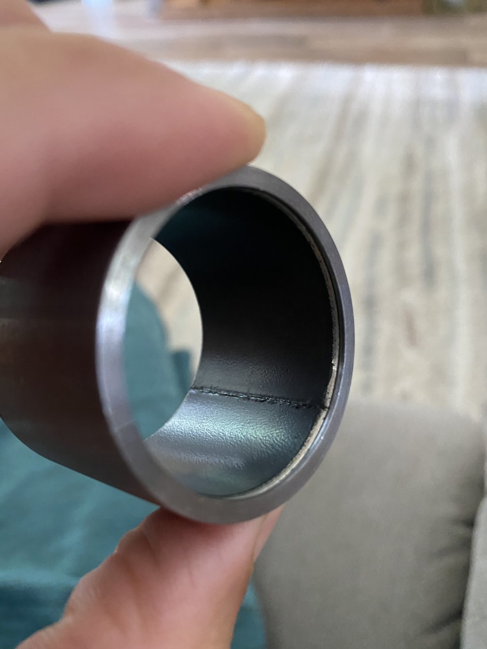

    I just received my ECGS bushing and noticed the welding seem inside is not super smooth. Is it normal to be able to feel the welding inside?
    Superdave1.0 likes this.

    Pic?

    2nd and 3rd gen. Not sure if that includes PRO.
