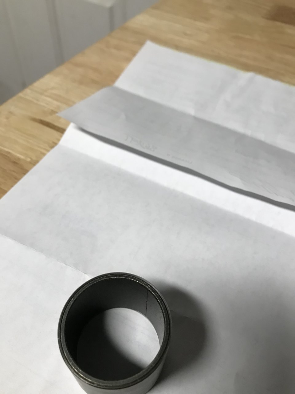

    I have one in my tool box, I'll check for that weld seam...Smoooth as could be. Got mine from ECGS a couple years back, Justin Case. No vibrations Yet and I'm on my second "lift." Going on 70,00 miles actually. I still keep that needle bearing kit in my tool case...Justin Case.

    The ecgs solid bushing failed?

    Yes. Toyota said that they give a 3 yeart50k mile warranty on it. In two years I drove 70k which made me out of warranty. He said when they removed the old ECGS bushing that it looked like the metal was flaking away
