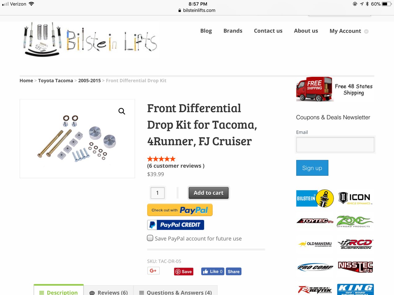

    Chipi3s likes this.
  20. Feb 20, 2018 at 6:16 PM
    #160
    Mod fan
    Mod fan Well-Known Member
    Jan 21, 2018
    #241938
    227
    Just picked this up when I do my install in a few weeks.... if it doesn’t work at least I tried, and I’ll go the other route truck has 250 miles on it 89B59D32-E539-4E39-87B5-9BB5619FA20B.jpg
