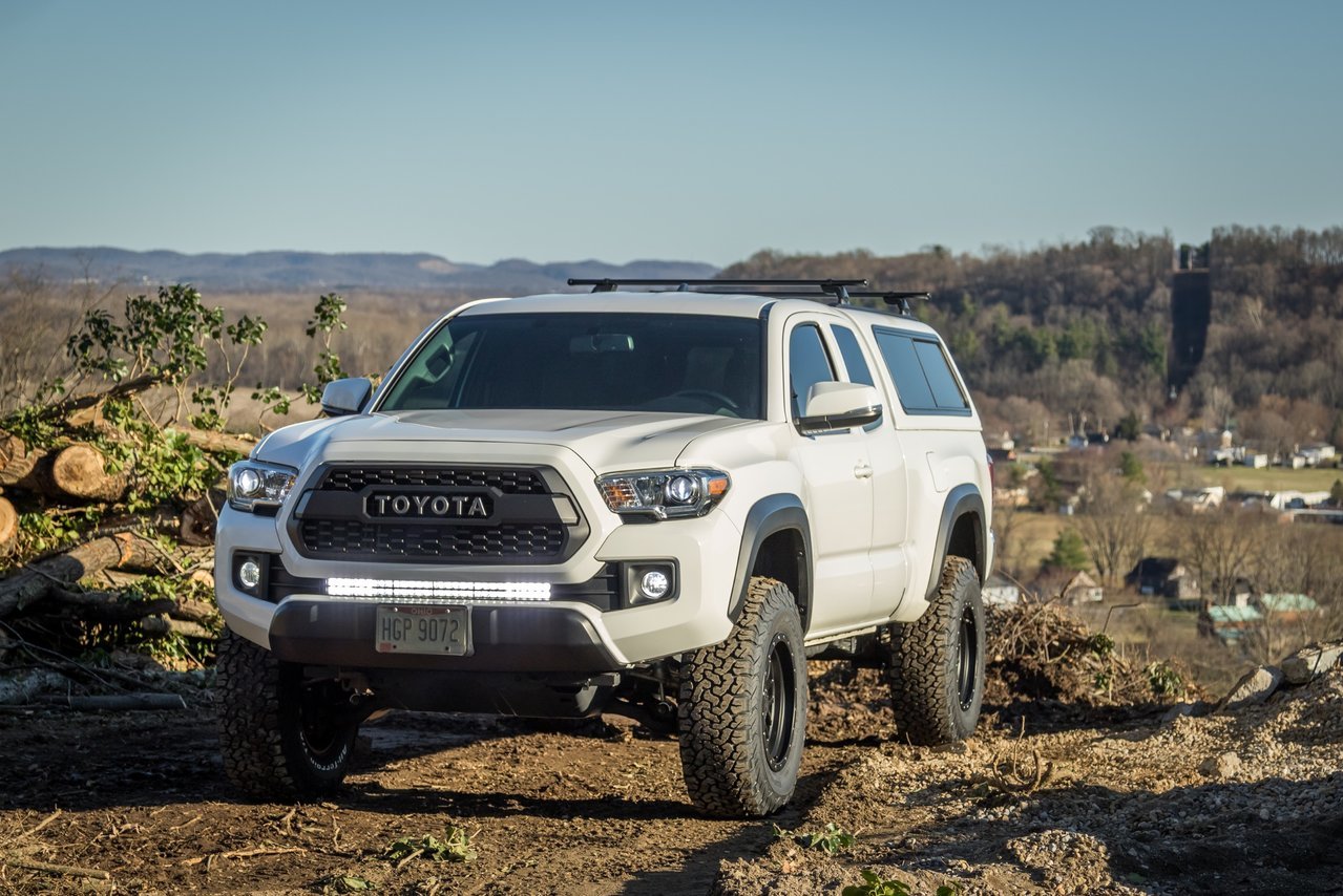

    I just installed the exact same lift a week ago and did the ECGS bushing when I lifted. Over 100 miles on it now and I have NOT felt any vibs.

    And nice looking rig by the way :thumbsup:

    sexy truck for shore man
