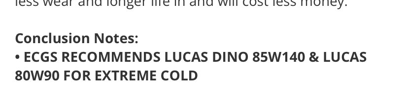

    Show us where you see these issues with people using heavier oil? If one of the biggest gear supply companies in the US recommends it, and issues aren't popping up on these forums then what's the issue? So many people on here do the ECGS bushing swap and run the thicker oil. By now issues would have surfaced. technically 85w-140 and 85w-90 gear oil will have the same cold weather properties
    Remember Toyota also says its trans fluid is lifetime fluid and we all know what BS that is. Sometimes the Auto mfg. does not always know what's best and that's a fact.

    Thicker doesn’t blow seals unless the breather is clogged, at which point any oil will blow seals.
    On the contrary, on my last truck it called for 75W-140 full synthetic, which leaked like a sieve despite two axle shaft seal replacements (dealer replaced the full shaft rather than cut off bearings and press on new with seal), and since I was tired of that process, I dumped in 85W-140 conventional which never leaked another drop. No clue why and I don’t think 85W is special, but obviously it ain’t hurtin.
    I’d only be against the thick stuff in an extremely cold environment, otherwise it really just doesn’t matter.

    I live where winter happens and ran 80w90 in my 2005 after ecgs bushing install.

    I said thicker is more likely, but I live in cold, so there's that.
    But if it doesn't matter, why run anything but what oem calls for? Let alone a massive change to 85W140

    I only run the thick stuff because I drive it hard. I wouldn’t say 75W-90 to 85W-140 is that massive. Yeah, big number change, but real world it’s not that big of a change in thickness. 75W to 85W cold is a small difference and 90 to 140 hot is a small difference.
